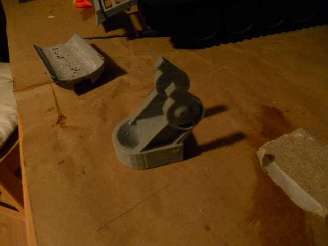

I thought that I had better do something in the way of printing a part for this project, so I did the main barrel support. It was quite a chunk, took five hours to print. It's not totally scale accurate, the reason being that this part is the main support for most of the gun, so I went for strength whilst making it look the part.
I will do the barrel next, as that is all ready to print, though I have had to split it down into several sections that I will have to assemble.

You are spot on. There is no time saving with a 3D printer, it takes a lot longer to design a part, and potentially hours to print, that's assuming that it doesn't take several attempts, and even then the printed one may need modifying...so its start all over again.
Some parts simply cannot be printed as a whole so they have to be designed as parts that will fit together...and that is another ballgame altogether.
