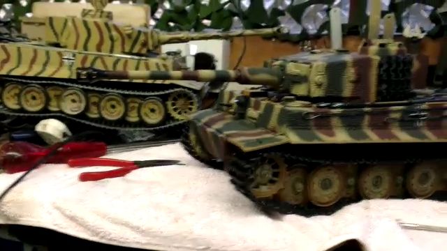

my mako 2 board arrived from oz , only wanted it to stop that stupid track spasm when firing the main gun.
fitting was fairly easy . just have to cut the red wires going to the track motors and connect them into the terminal blocks on the mako , had to solder 2 extra lengths of wire to each one becauce once cut they too short to reach the mako board.
like i say fairly easy fit and works perfect , just gun recoil and no track spasms lol ,if anyone wants to see any pics of this install let me know and put some on
best regards
Roy
best regards
Roy

Re: mako 2 board
[img]http://i201.photobucket.[URL=http://s201.photobucket.com/user/wizz262/media/IMAG0363.jpg.html][IMG]http://i201.photobucket.com/albums/aa123/wizz262/IMAG0363.jpg[/img]com/albums/aa123/wizz262/IMAG0364.jpg[/IMG][/URL][img]http://i201.photobucket.com/alb[URL=http://s201.photobucket.com/user/wizz262/media/IMAG0361.jpg.html][IMG]http://i201.photobuc[URL=http://i201.photobucket.com/albums/aa123/wizz262/VIDEO0015.mp4][IMG]http://i201.photobucket.com/albums/aa123/wizz262/th_VIDEO0015.mp4[/img]ket.com/albums/aa123/wizz262/IMAG0361.jpg[/IMG][/URL]ums/aa123/wizz262/IMAG0361.jpg[/IMG][/URL]
Re: mako 2 board
thx Alwyn,, hope you ca
n see the pics ok,,sorry video is a bit shaky was trying to hold phone and fire main gun lol

Looks good fair price as well
