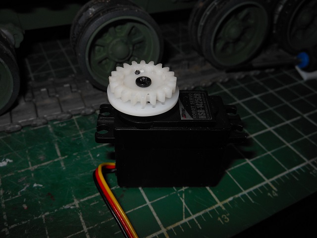

The first thing you need to do is to remove the final gear from the HL rotation unit and mount it onto the servo. I left the pull "circle" on the servo and mounted the gear directly on top and also put in a stop screw so there is no movement between the two:

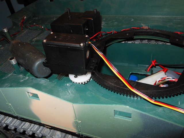

Then I realized that there is couple of ways to install the replacement servo rotation unit:
In the original HL position which can be mounted next to the smoker unit. You will have to remove the battery compartment since the servo needs the vertical space
On the side of the upper hull but there is no easy way of mounting it.
On the lower hull which requires some alignment when you put the upper and lower hull together.

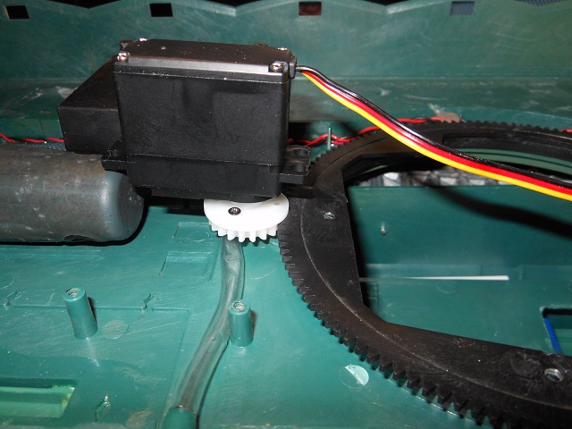

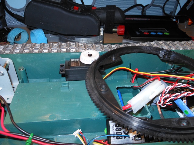

I ended up with mounting it on the lower hull as I realized that by mounting it on the lower hull, the moment you separate the upper and lower, your turret is completely free to move. This installation actually is identical to how a real tank's rotation would work as the turret usually just sits on top of the rotational unit. I really like the idea that the turret is no longer fixed to the upper hull and I always hate the clutch on the HL unit so this really kills two birds with one stone. The only trick to this mounting is that you will need to align the cog ring so that you know where the servo should be positioned. I basically put the hull together, hot glue the cog ring to the lower hull so I know it is exact position and then mount the servo on the lower accordingly.

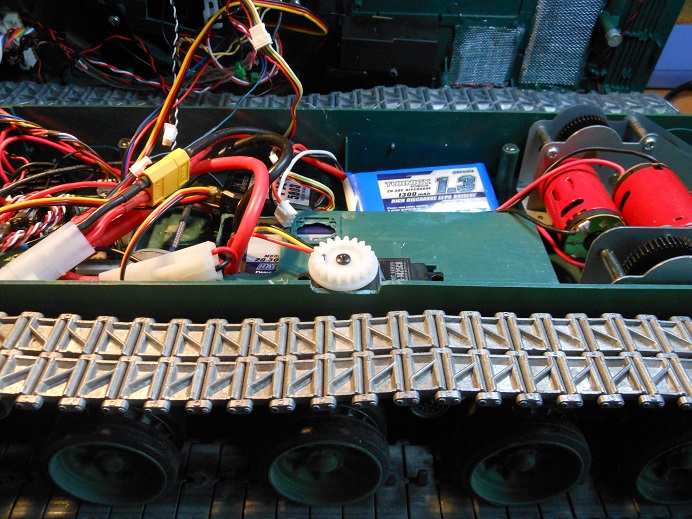

Final picture (I have to clear some lower hull side wall to fit the servo gears).
The differnce I found is that it is much smoother, faster(still not as fast as I would like but much better than HL), more responsive and you can also program this on a pot/knob on your radio as well as the usual left right on the left stick which makes it a little more interesting.
