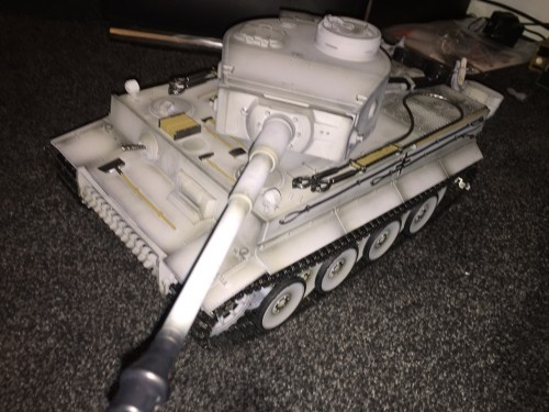

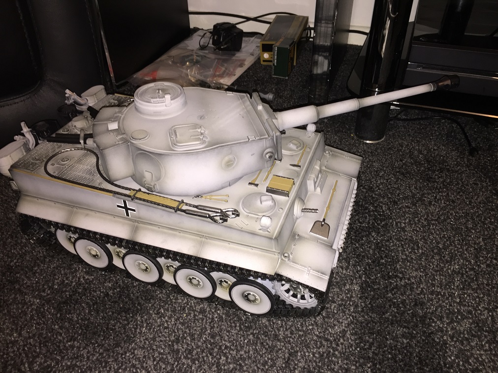

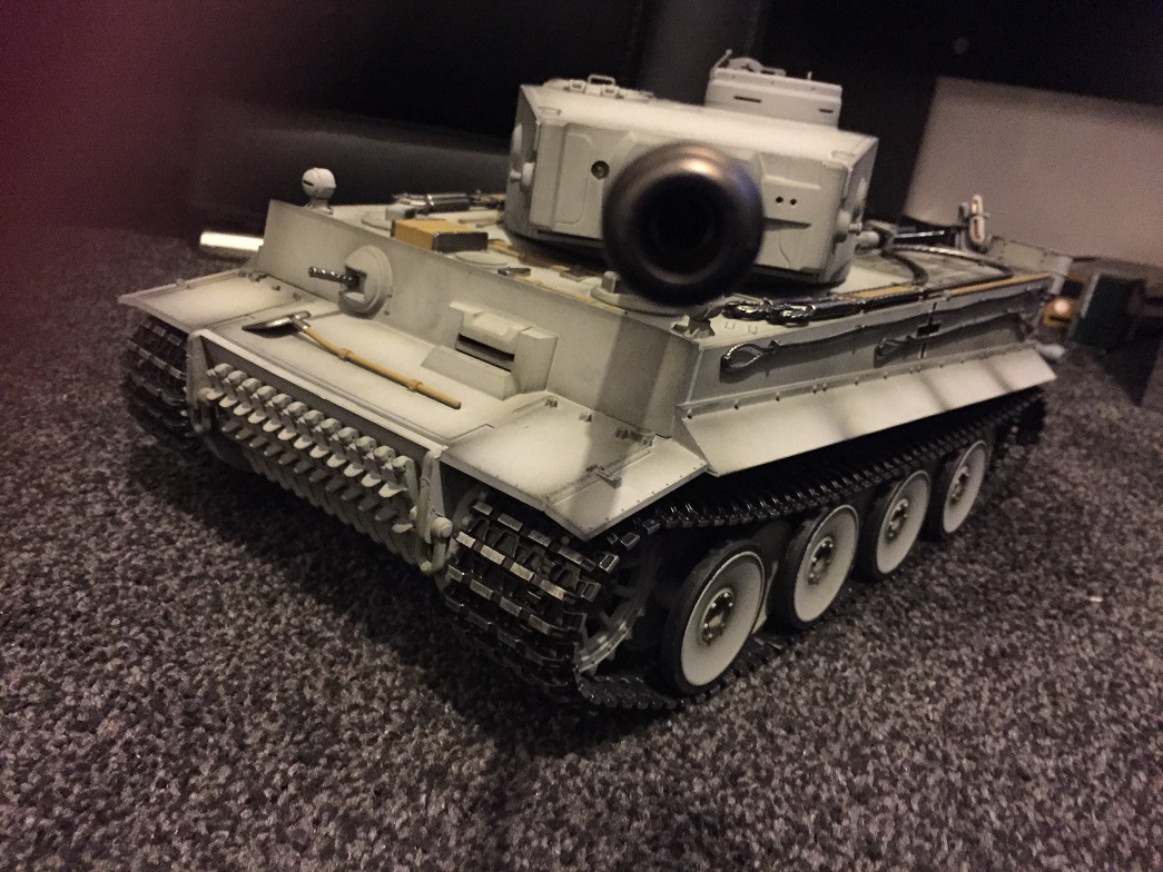

Hi after posting on here getting help from every one thanks guys, and speaking to forgebear on ebay (he give me alot of advice nice man)
i got my first tank had to be the fearsome tiger @)
i want a MG42 for the top of my tank what els can i get to add to my tank?
also is it safe to drive my tank when its wet outside?
thinking of tanking it to some woodland
