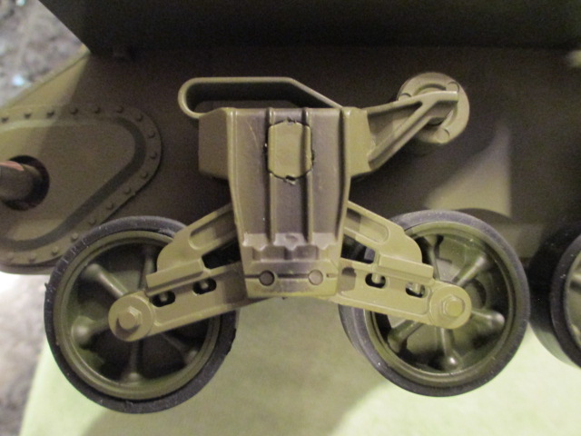

When the HL Sherman came out, folks were going through the same thing when trying to use Mato running gear and tracks on the tank. No one was happy with the HL single pin hollow tracks in metal or plastic. They worked well but were a mess sight-wise. You had to do a little filing on the shafts of the gearboxes to make the Mato sprockets work so you could use the other style of tracks. The idlers were differing sizes as well in width and diameter. Eventually, one of the companies caught on , (I think it was Mato ) and brought out metal tracks and sprockets\idlers that were a direct swap onto the HL Sherman. I was one of the guys playing around trying to get the Mato rubber tired road wheels to work on the HL bogies. I didn't like the hollow backed road wheels that came stock on HL's bogie assemblies. I made it work by a slight ream on the Mato road wheel that allowed it to slide over the HL plastic 'bearing'. ( right as I did that, Sassgrunt shipped me a set of fantastic dished late war road wheels made out of the HL wheels and lego parts which I used on my Sherman, 'Maxene'. ) I find it interesting that Taigen's new metal Sherman comes stock with late war dished road wheels. Try to have fun with this stuff, Jack. It's all part of the modeling aspect of the Hobby. ;o)
