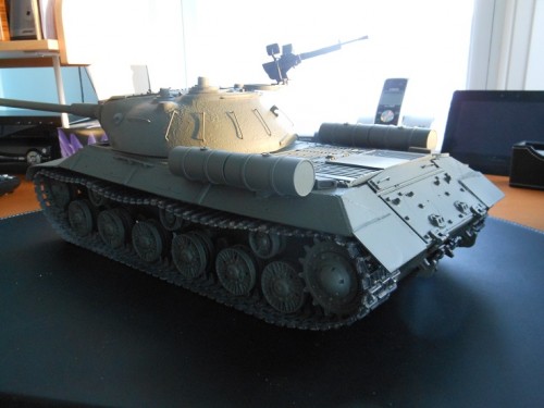

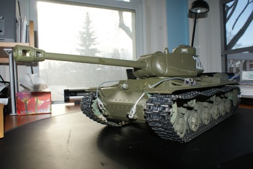

JS has a completely different chassis than the KV, and only the JS-1 shares a turret with the KV-85 and not the T-34/85. I have done a KV-85/122 and a JS-3 both based on the KV chassis, but the turret for the KV-85 is a custom kit, and so is the upper and the turret for the JS-3.
KV-85/122 which has the KV lower and a custom JS-1/2 turret.
JS-3 (KV lower modded with a custom upper and turret)
