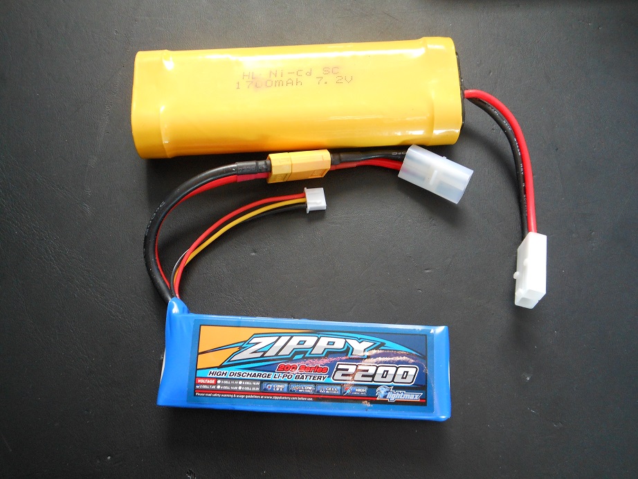

In terms of space, I actually find that for the same mAh battery, Lipo in general is actually smaller so you shouldn't have any issues. Also, on the Hobbyking website it gives you the exact dimensions so you can find the right size for the battery box.

Just to give you an idea, here is a 2,200 mAh lipo compared to the standard HL NiCd form factor. The Lipo has XT-60 but you can get Tamiya adapters for them.
MichaelC.
