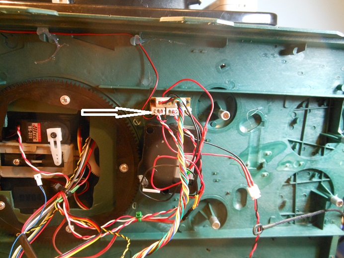

Welcome to the forum Richard. If barrel recoil and eliminating the standard HL hull recoil is your goal, you will need to look at replacing the electronics unfortunately. I think most forum members here uses either the IBU or the Clark after market solution to get the barrel recoil and rid of the hull shake. The good news is that it is mostly plug and play, but you will have to do some work on the recoil piece. The HL Leo is pretty easy to convert to servo recoil using the existing BB mount.
Here is picture of mine (ignore the arrow as it was for something else) with Clark board and also a quick video:
http://youtu.be/b0zatMuPQW4
You will notice that I still have a little hull recoil as I like a small amount of hull reocil but with Clark and IBU you can adjust the amount so that it is not so earth shattering.
MichaelC.
