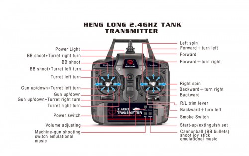

Hi all.. Just a few words on the new 2.4 gig controller.this is a big leap forward in heng long actually it's dam good what I have seen got no price yet but looking forward to getting me hands on this takes the last bit of ( TOY ) out off the out HL, TANKS.anyway take a look . See what you think. And happy tanking

I've seen this before but can't get anyone to say if the trim switches actually work or if they are glued in place.
Joe
Re: new HL.controller
Well since the left stick is a multu function stick you can't really have trim like a hobby grade radio. Funny enough it does say L/R trim for the right stick but not Forward/backward trim.
The slightly older set would appear to be glued in place - that or they're incredibly stiff! Haven't needed to trim anyway.
