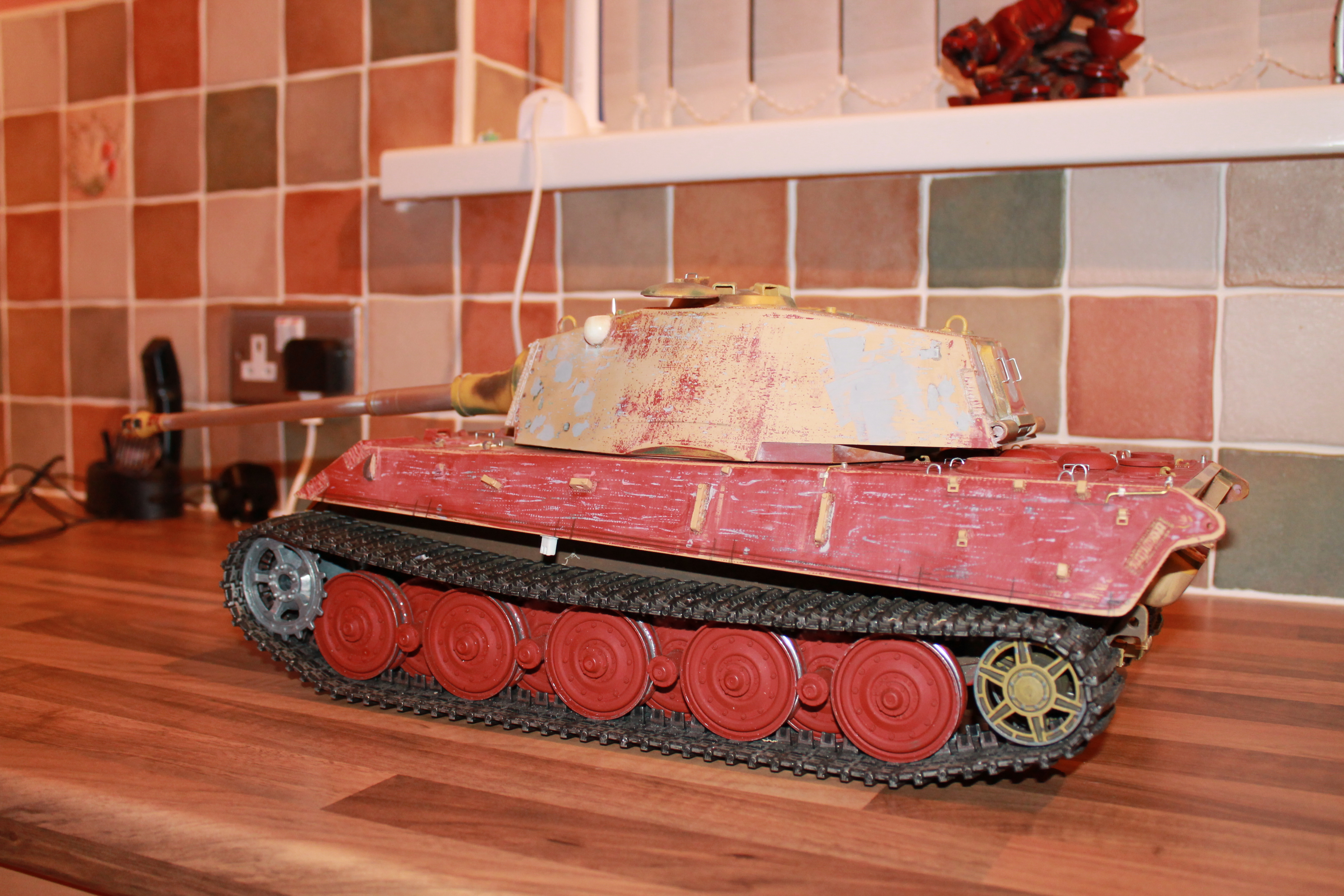

This is a full option Tamiya King Tiger remodeled to represent a 1946 spec model. There have been quite a few modifications done to the chassis and running gear to make her a reliable runner and battler. Here's a list of what was done.
Reinforced standard Tamiya gearboxes ( drive cogs bushed out to remove excess play on shafts ). engineering done by Nigel I hasten to add :D
Improved Shumo torsion bars fitted to last 6 whee l stations on both sides for softer ride.
Gear box output shaft supports ( bushing type ) fitted externally to reduce strain on gear train.
Shumo rear idler fitted to improve track tension and reduce rear hull flex.
Bearings in all 16 road wheels.
Custom built battery, electronics and speaker holder.
MG ball removed and filled in.
The upper hull has had HL rotation added with faster motor to improve turret rotation speed. Scratch built rear 3 piece engine access hatch and vents. Added fuel vent lines.
Turret now has HL Stug elevation unit fitted ( needs a little more work to lock things down things a tad as the barrel is still a bit wobbly )
IR emitter fitted to front face on turret
Range finders added to turret sides.

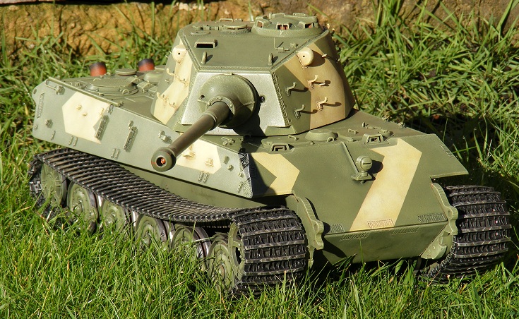

Now for the good bit a couple of pictures :haha:. The tracke in the picture are single link tracks to run on the 18 tooth sprockets, since then I have shredded a set of tamiya gear boxes ( hence the bushing upgrade mentioned above ) and gone back to HL King Tiger plastic tracks and 9 tooth sprockets on which she runs much better and with far less stress on all the automotive components :D
Tankman
In her natural environment
My take on a late war colour scheme

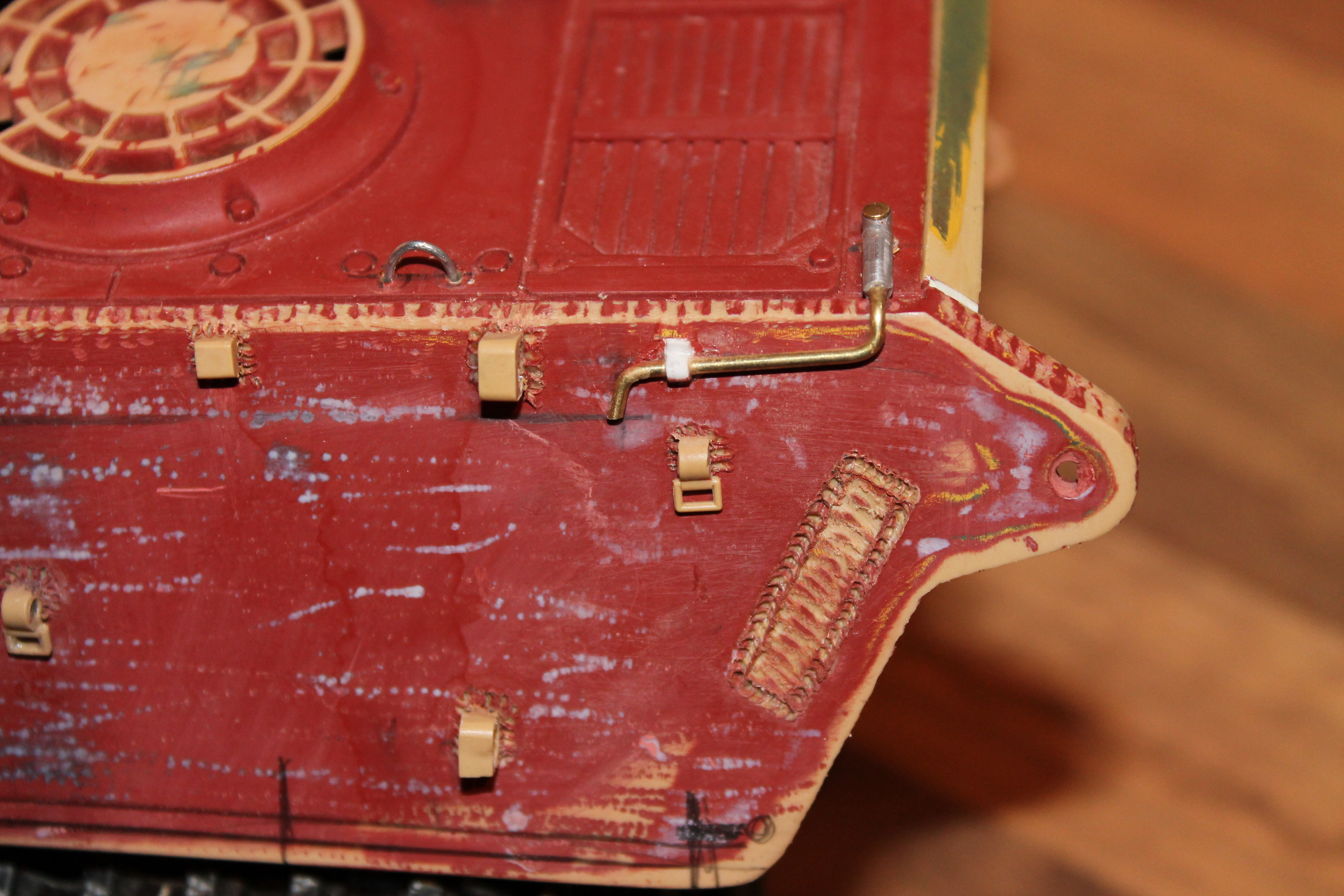

Fuel vent lines
Fuel vent lines

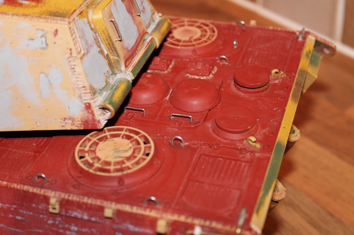

Three piece engine access hatch

The Cat-King looks so much better with no guards fitted.
A 1946 version must be quite liberating to do - no photos or facts to stop the progress :thumbup:
I suppose night vision gear would also have been the goods in the next year of the war, with the western allies joining forces against the 'Red Hordes'.............
Trust me................the "Octopus Ring" paint scheme was dropped in November '45 in favour of the one you are doing :/ :haha: :haha: (just to hard & variable)

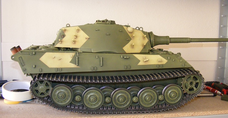

Wouldn't the tracks have a bit more slack than that, though? Shouldn't they touch the tops of the middle 4 or 5 road wheels?
JagdPanther / Leopard 2A6 / StuG Ausf. G / KV-2 / M4A3A4 / MTLB / 2.5 ton truck 6x6
tankman
Re: King Tiger 1946
Post by tankman »
You are right Lert in real life the tracks did indeed run very slack. Unfortunately I had to put more tension on them as they kept skipping on the sprocket when running in grass, the tension in the picture was a compromise between reliability in battling on grass and reality. The plastic tracks have to have even more tension to be reliable in battle. All the best for now.

Posts: 7632
Re: King Tiger 1946
Tankman,
I think that Lert was mentioning the tracks in the third picture where the tank is on the counter and appears to me to be up on a stand. In the fourth picture where the KT is outside, it's tracks appear fine and are correct in slack.
