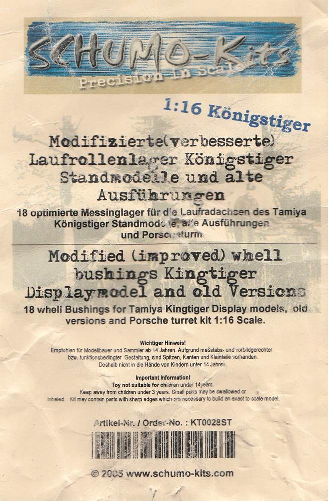

I have being in touch with Axels Modellbau's model shop about the replacement wheel bearings that they
have advertised for the later version of the King Tiger, but they are not, apparently, compatible with my ancient
version.
So, the plan at the moment, is to try and source some replacement bearings, but if anybody has any other
suggestions on how to cure this problem I would be very grateful.

These are the one's I've fitted to mine. I'm pretty sure they came from Axel's Moddelbau but it must have been about 5 years ago.
They appear to be longer and made to closer tolerances to drastically cut down on the wobbling of the road wheels.

Thanks for that, looking at the part number (KT0028ST), quick search done on good old
Googly poo, and they appear to have soom in stock at tankzone.
That's some crimble money spent.

Went online on Monday, ordered replacement bushings from Tankzone, and paid with
Paypal.
Then I was burbling about on some other posts on this website, and found, what can only be
described, as not overly flattering reports about Tankzone, bugger thought I, why didn't I
read the forum before ordering.
Yet today (Wednesday) one well packaged envelope appeared at my work, :clap:
Test fitted on one wheel, and it is totally amazing the difference they make, no more wobbly wheels.
