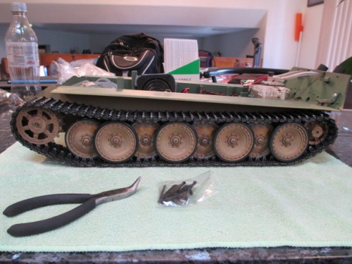

It looks like your tracks could benefit from having a link added to each side. They should sit a little looser on the running gear and not pull on the sprocket or idler. This might be your issue. I've gotten rid of a few instances of pulling from side over another by loosening up HL's overly tight tracks. They should sit like this picture:
regards and good luck,
Corrected slack
Corrected slack

Thanks painless...that's awesome advice! I noticed the tracks seemed tight like a rubber band tight but i thought they were supposed to be like that from the factory. Now i know what my next project is.
