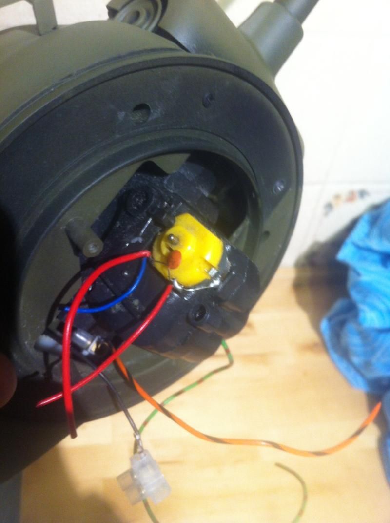

Ok, ahead of trying the diode method here's the cables I have coming from the motor. As you can see its a really old version. The stripes wires are new cables running to the elevation motor.
Any ideas or am I doomed to the dreaded diode method?
MichaelC
Posts: 2449
Location: Toronto, Canada
Re: Please dont ask why..
Post by MichaelC »
Hmmm......Looks like it is from the old Non-Smoke and Sound version which means that you won't have a trigger for the sound and hull recoil so you might be stuck on the diode method. It is quite straight forward as long as you are using an RX-18 and pretty good with the soldering. The diode is fairly common and you should be able to get it at any half decent electronic parts store.
