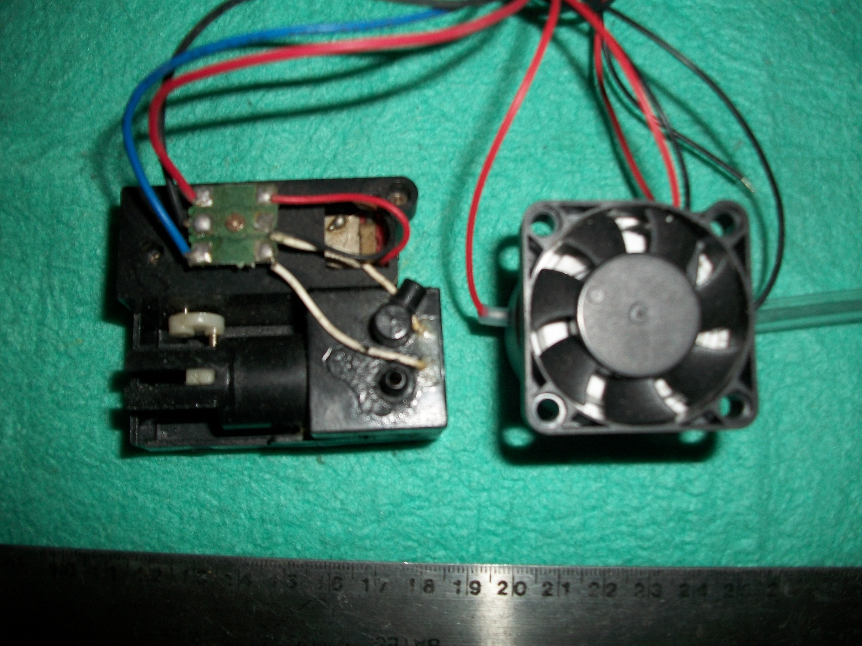

I wanted to give you all an update on the Super Smoker II after the melt down the original one had and I had some time with its replacement. The replacement started out well and showed promise but now has also gone bad.
The 1st issue it started with was that it would work in my Tiger but not the King Tiger I contacted the builder and was told that some tanks RX boards didn't put out the proper current and he recommended using a second battery to power the smoker. So I installed a 2nd battery and the smoker worked great! For about 10 minutes and then no smoke, turned out the exhaust tubes melted so it was off to the hardware store for some higher temp tubing and that lasted about 15 minutes before it too melted shut. My next stop was the auto parts store for some silicon hose which doesn't melt and that seemed to do the trick but then I noticed the smoke was puffing out rather then a nice steady flow. I opened the engine hatch and found the fan would spin then stop then spin then stop again.
At this point after 2 smokers and following the advice of the builder and buying more and more parts to try to make the smoker work at this point I have to recommend members pass on this smoker as they are not reliable IMHO. I would rather have no smoke at all rather then attempt to try another Super Smoker II.
I'm considering using the parts from the new one to build my own smoke unit.

The unit is built and sold by the gentleman whom you named in our PM's Saxon and he is a very nice guy. His design is sealed meaning once he builds it its like its glued together which may be one of the problems if the wick needs to be replaced every so often as that could account for the first smokers death.

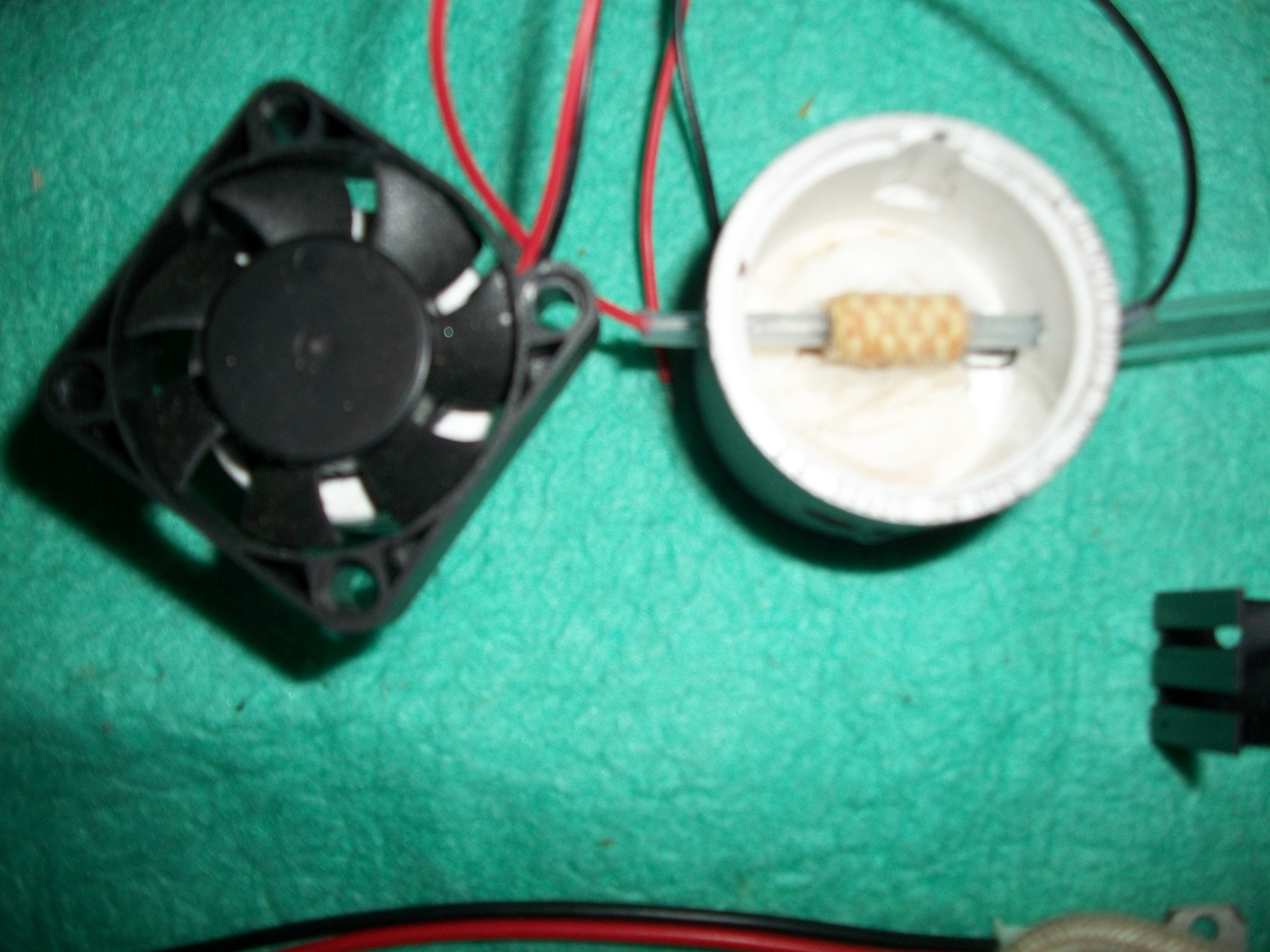

The 2nd unit has been plagued with fan issue's almost from day 1 and I was told by the seller/builder to use a dedicated battery for just the smoker and that seemed to solve the problem as the fan ran steady and it heated up VERY fast. But then the fan problem came back and the smoker now running off of a battery wired directly to it gets so hot that it causes the exhaust tubes to melt shut inside the body of the smoker. Silicon hose seems to be the answer for the exhaust tubes but the fan problem seems to be from the circuit board itself as I tried a different fan and it does the same thing.
When these work they work VERY well the only issue is they keep breaking down. I'm not going to contact the seller/builder again as he seemed annoyed that he had to replace the first unit and took 3 weeks to do so and that was in addition to the 4 weeks it took me to get the original unit. I have the circuit board form the first one along with its fan (I got angry and threw it across my front porch smashing it after it almost destroyed my Tiger) and the 2nd unit he sent me to replace the melted down one so I'm considering combining the 2 to see if I can make one that works and lasts more then a week or 2. I plan to use Nomex and Kevlar to make my wick which should make it last a very long time.
I used the fluid supplied with the unit and Mega Steam. I talked to the maker of Mega Steam and the maker of the smoker and they both said Mega Steam would be fine to use, and I also used the smoke fluid that came with the tanks. But other then that nothing else.
This is the site that claims to sell the original Super Smoker II but now I doubt that claim after Saxon's story. http://www.radiocontrolcustomtanks.com/index.html

I'm SURE it is the same as Saxon's just seems to be plagued with problems. The one you show Alpha is kinda like the one I have but the circuit board is made onto the PVC housing.

Hold on there Jack....so you are saying the guy wired a piece of PVC instead of using fiberboard?...that's just crazy ...sounds mickey mouse to mejackalope wrote:

ALPHA wrote:Hold on there Jack....so you are saying the guy wired a piece of PVC instead of using fiberboard?...that's just crazy ...sounds mickey mouse to mejackalope wrote:

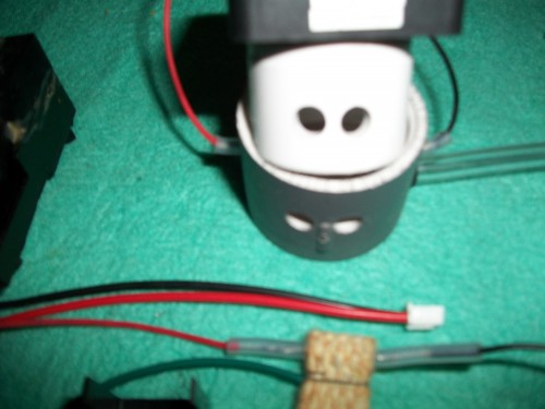

No sorry. The circuit board is a normal circuit board and it attached directly to the PVC body of the smoker.

Ok Guys,Carl is the one person I gave my design to and agreed to not interfere, I cannot blame him as we are all just small designers with small budgets.
But I also gave the design to the forum first when Phil died. The post was deleted,and I will not go into that. So lets just focus on solutions,its what will create the best result. The original works because Dan,me and Normond tested many resistors trying to created fire. Because in 2009 their was a FIRE and meting TIGER does look cool,but the 800 dollars in tank did suck after the smoke cleared.
I wrote Jackalope the reason why our unit worked,and the cost. Kevlar wick material ,but even then I stapled the kevlar in a lope around the heating element so the kevlar could be rotated. The material will become brittle after a time. Second the resistor,very expensive yet consistent heat. Third the Housing was a pain to machine,and required time per unit,but each feature was purposefully created.
Now Carl is a good guy,and I can't and am not blaming or criticizing him as these are tough units to reproduce.
I have mixed feeling about my absence from this forum,and not sharing more of my designs. Perhaps the time has come to share the material again? I design with a focus on the Hobbyist being able to reproduce and purchase all the components themselves, the Hobby had and has this segment which feels the designs and modifications are some kind of status or intellect indicator and creates this elitist status.
Well stuff that, yet I also am restrained by my own success. I cannot share some stuff because I sold the designs. But not the SMOKER thats mine,and I could do as I wish. So I will first contact Carl who has worked hard to make a better unit,and improve the ability.
Lets give credit to a Hobbyist who at least tried. we all know the H/L unit is trash. And their fluid only belongs in the trash. These are a bit of a pain to produce, So maybe we can fix the design issues and bring a desirable unit to the Hobby.
Terry please send me your address, might be I can send the housing which does slide apart and with the parts you have the unit could be salvaged. Carl is a dedicated tanker,I was to call him tomorrow anyway so now we have a problem to solve and perhaps together can sort this out and benefit everyone who wants smoke. By the way,I am producing large scale units and have had some success , so perhaps the real person to fault is me, I am regretful for my absence. I am trying to become more engaged again. And school is over for the foreseeable future.And I have a broken tank or two to repair and one 1/6th scale Dragon Sherman to assist in building. And three others so I need the forums help, and some guidance as well.
One other point,the PVC housing is the best material,and the size restraint dictated this being used. But finding a flat bottomed end cap was a problem, originally I had to turn the bottoms flat on the lathe. So that being said if someone has a solution,or a different housing which will fit the space please demonstrate this so we can move forward,but I am sure that the PVC is the best choice having tried at least 4 other enclosures.
Lets just figure this out and enjoy the challenge.
cheers Blake
