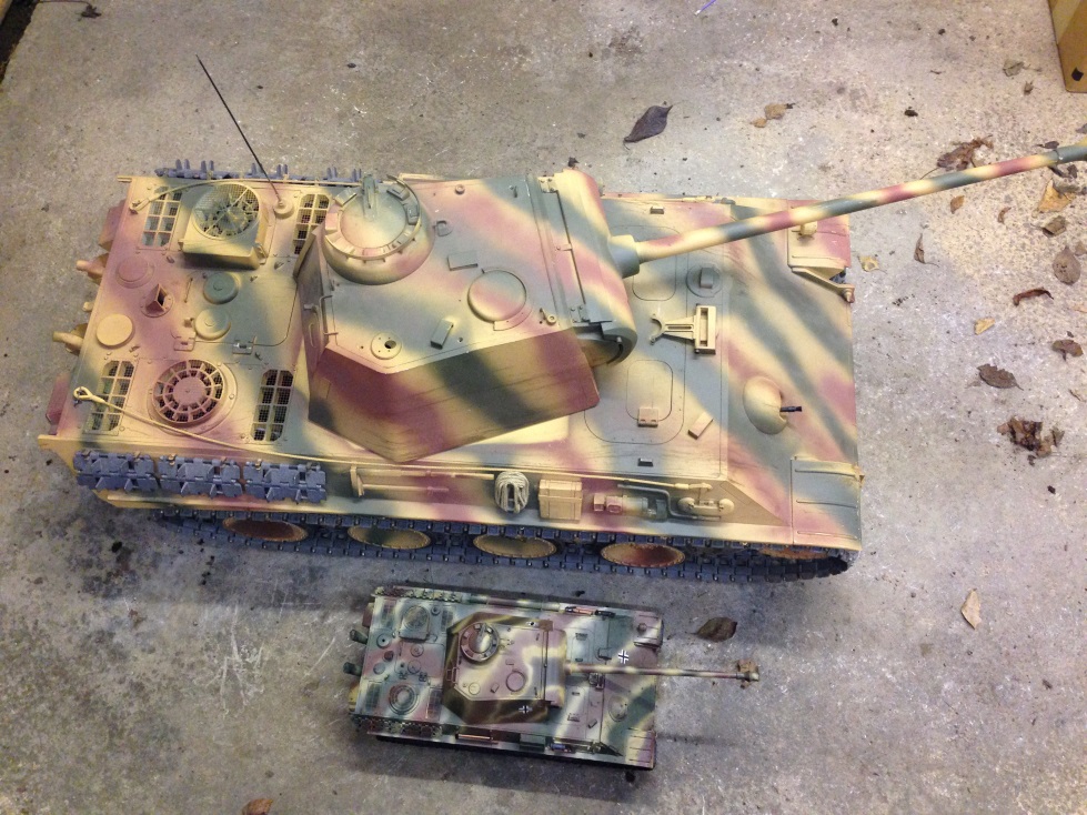

Hi all, I just collected my first 1/6 tank today.
It is a series one Armortek Panther G and is pretty well stock.
I am planning to get some sound into it as a priority and then look at some upgrades to improve the level of detail.
That is a Heng Long 1/16 Panther next to it.
This new Panther is HUGE but has loads of potential.
Tim

Good Afternoon,
Nice on the Panther, Swamp! It looks like a very solid base to work from and detail out to your heart's desire. Much enjoyment there!

Nice, did it come with motion pack or any other extras?

Hi, it comes with the motion pack and a number of engineered mods to improve running but is essentially stock.
It is from the original batch from 2007 that was designed for a blank firer. These are not available any more from Armortek, and they do a recoil option now for the current range.
Unfortunately, it is not a straightforward job to retro fit into mine but it is possible.
I am wanting to get a smoke unit and sound module pretty soon, but am happy to leave the recoil for now.
I also want to find some working lights.
It seems odd that the level of detail on my completed 1/16 Panther is much better than the stock Armortek. Having said that, i think the later series was a bit better.
Tim

nice new toy Tim.
and if you get feddup running it you could use as a storage box for your 1/16th tanks
