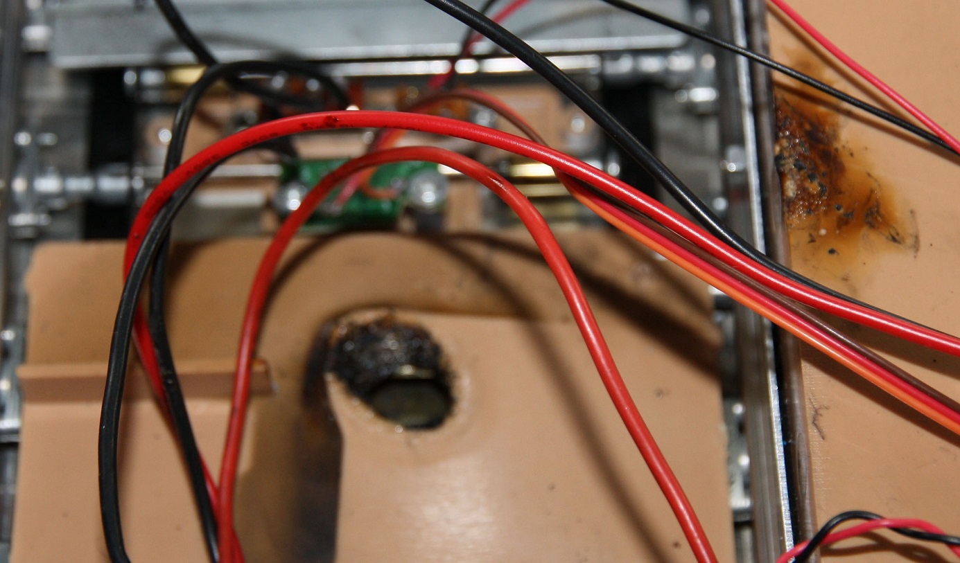

Damage to hull

Damage to hull,not too bad thankfully.

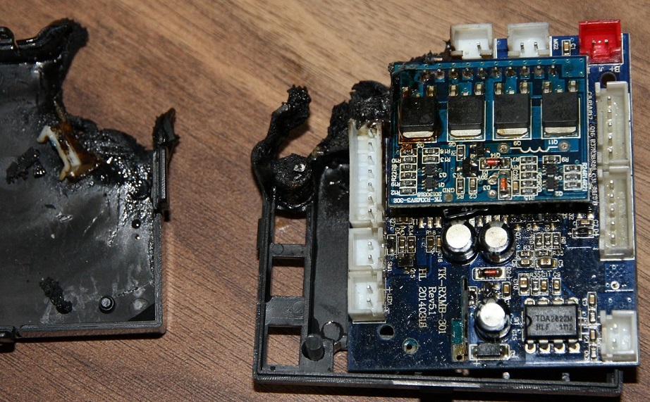

rx18 unit all burnt out.Now consigned to bin.

Good Morning,
That is some damage! I know that the end of the Binding cord is a Button with some exposed contacts on the bottom. Any chance that those touching metal or another wired connection may have caused this?

Wow that is quite spectacular. Since it wasn't the motor leads or the battery lead, Painless is probably on the right track. This is not because of the load on the MFU. It could very well be a bad solder job somewhere (binding switch or the board) and when you run it long enough (probably took a while since it is not high amp or voltage) it builds up enough to catch fire.
