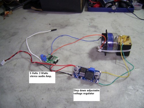

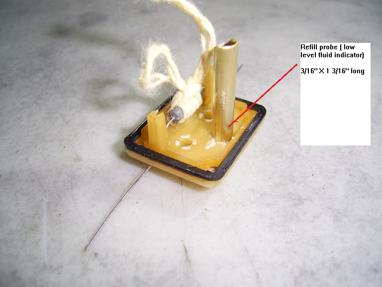

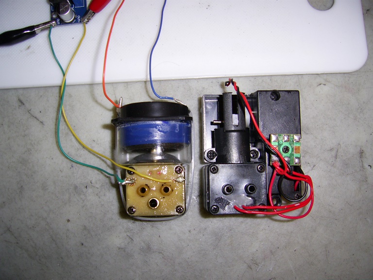

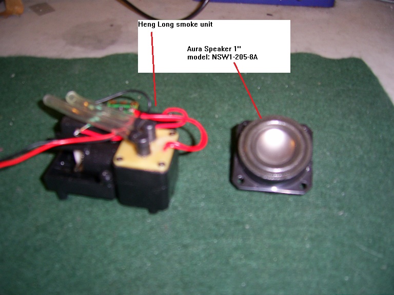

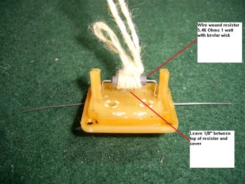

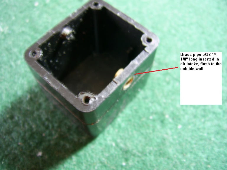

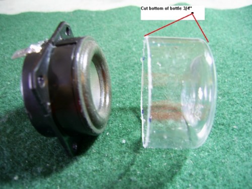

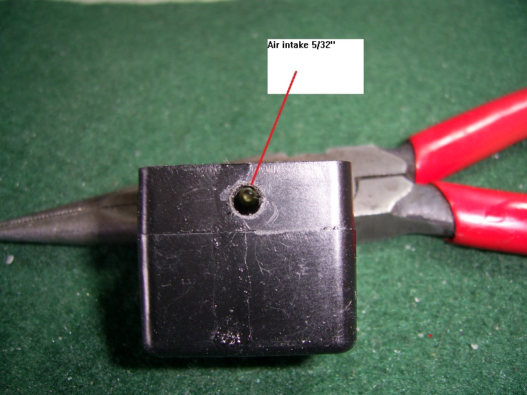

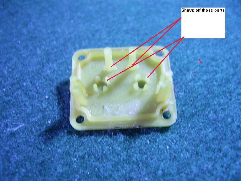

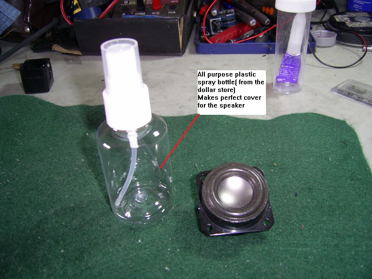

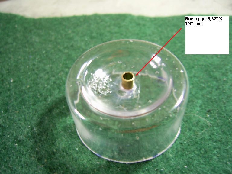

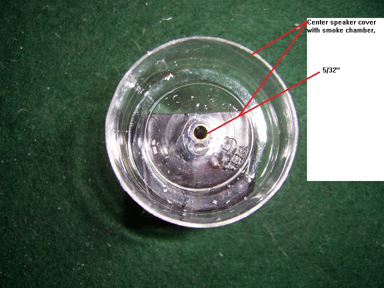

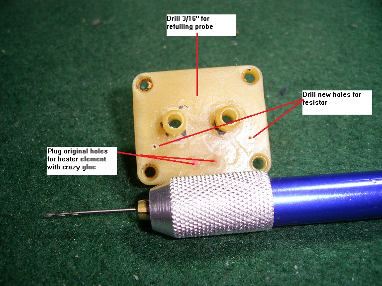

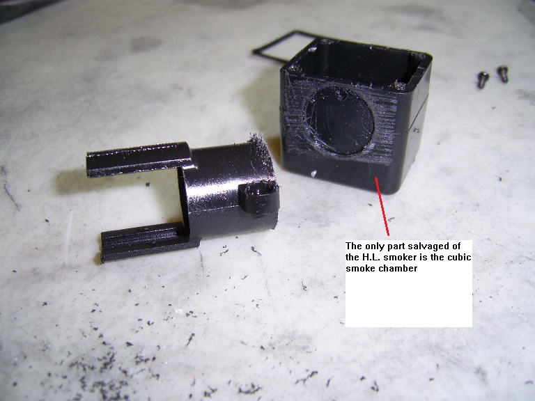

The acoustic smoker has been working out and has now become a " lean mean smoking machine" :haha:
The overall size has been reduced and the electronic has been modified to reduce power consumption, while remaining efficient...
Here's a bunch of pictures with commentaries to explain the mod.

I've been looking at all your different attempts of this, on YouTube, and have to say I'm very impressed with your efforts. As a complete newbie to the world of RC tanks, and having no knowledge of electronics I still find it all rather confusing. I have been trying to find the wire wound resistor, here in the UK, and can't seem to find the exact one. Is there something similar that I can use ? I'm assuming it's used instead of the wire & wick method as used in the HL smoker, and heats up, without burning out. Again, making assumptions, I guess the amplifier is used to boost the effect the speaker has on the air movement and the step down voltage regulator will control the heat, and hence the smoke output. I'm hoping to fit either a Clark TK 22 or IBU2 board to my HL Leopard, so could I connect your setup directly, or do I have to have the other two components ?

machine wrote:I was able to find the step down, but where did you find the stereo amp at? Can't seem to find one anywhere on the net.
Here's the address for some 3 Watts stereo Amps that I used before...You have to remember that those need to be powered at no more than 5 Volts and you need to add a volume control ...http://www.ebay.ca/itm/Mini-Digital-3W- ... b65&_uhb=1

Trailbiker wrote:I've been looking at all your different attempts of this, on YouTube, and have to say I'm very impressed with your efforts. As a complete newbie to the world of RC tanks, and having no knowledge of electronics I still find it all rather confusing. I have been trying to find the wire wound resistor, here in the UK, and can't seem to find the exact one. Is there something similar that I can use ? I'm assuming it's used instead of the wire & wick method as used in the HL smoker, and heats up, without burning out. Again, making assumptions, I guess the amplifier is used to boost the effect the speaker has on the air movement and the step down voltage regulator will control the heat, and hence the smoke output. I'm hoping to fit either a Clark TK 22 or IBU2 board to my HL Leopard, so could I connect your setup directly, or do I have to have the other two components ?

It seems that wire wound resistors are very hard to find in continental Europe..I buy mine from this site in the USA:http://www.surplussales.com/Resistors/W ... 51-99.html
But I was told that shipping to Europe was exorbitant, so if you go ahead with this project; just PM me your mailing address and I'll send you a couple resistors with wicks... :)
I've never tried the IBU2, but from what I read they would be perfect for an acoustic smoker...
They have programmable sound (Kind of like the TBS mini) and the engine & effects sounds are on separated outputs...
So the IBU2 could be used the same way I use the Clark/Benedini combo:viewtopic.php?f=33&t=11139

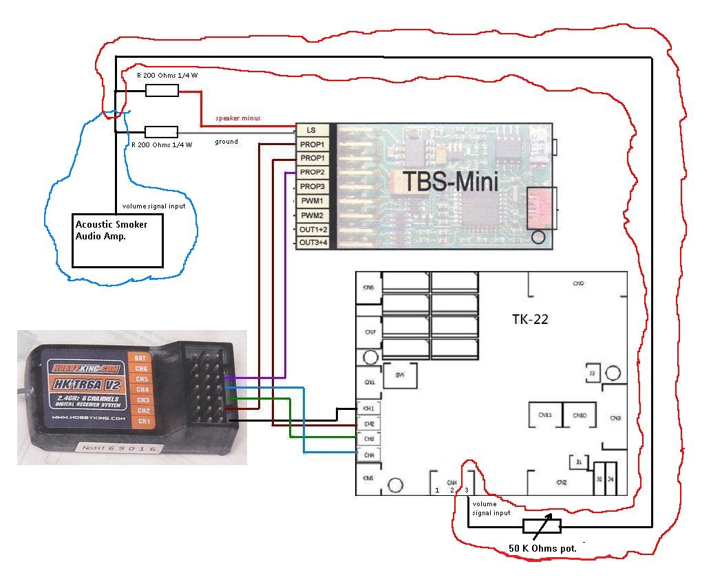

machine wrote:thank you for the links. Got my orders in and look forward to putting this together. So far the most realistic smoker out there. Question though...do you use this speaker in conjunction with the main speaker, or does this set also replace the main sound speaker?
I use it in conjunction with the main speaker since the speaker I use is only 1 " diam. and rated at 5 Watts RMS...
You wouldn't have much bass coming out of it; and the new design is also intended to get the maximum air flow at the lowest volume possible in order to save battery power...
I'm using a Clark/Benedini combo in my tanks.
The output of the TBS mini is split in 2; one part of the signal goes to the acoustic smoker and the other goes to the Clark audio amp. via a 50K Ohms pot. and gets mixed with the sound effects of the Clark board...
Here's the wiring diagram:
