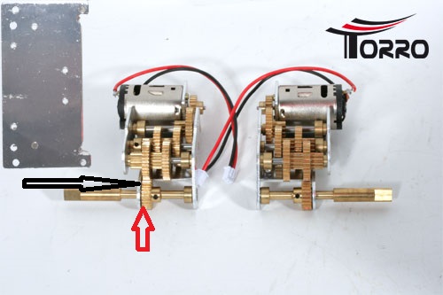

This is a photo of Sassgrunt's gearbox is it like the one you have Michael?

It is almost the same. The gear layout is identical other than the final drive :
The black arrow is where it is slipping, and the red arrow is pointing to the piece that as 971wright says, bending out when under load and separate the final gear from the second last one in ONE direction. The other direction pushes it in so it is not a problem.
I have shim a washer underneath it right now as it is mounted on the base plate as shown in the picture and is pushing the frame back in but I don't think it is going to work too well or last too long.

They look like the ones Pete was describing I had the same set in a panther I glued some pennies under the final drive gear to stop the frame from bending and it was fine after that
