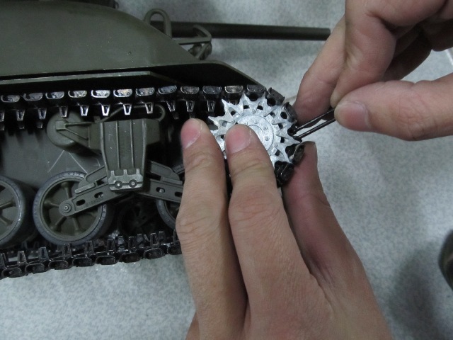

I have the same issue as Merlin, fitting metal tracks to the heng long Sherman - just can't see how to fit the end caps. The pins are the same at both ends - smooth and a very,very tight fit
I have tried fitting both pins pins into one end cap on the vice (requires a lot of force) and then sliding this through the links to be joined. see picture. But I then have no idea how to fit the other end cap.I find it impossible to line up the two pins with the other cap and apply enough force. There must be a simple answer/technique

tanku wrote:I have the same issue as Merlin, fitting metal tracks to the heng long Sherman - just can't see how to fit the end caps. The pins are the same at both ends - smooth and a very,very tight fit
I have tried fitting both pins pins into one end cap on the vice (requires a lot of force) and then sliding this through the links to be joined. see picture. But I then have no idea how to fit the other end cap.I find it impossible to line up the two pins with the other cap and apply enough force. There must be a simple answer/techniqueImage
Great picture Tanku :D ...you are half way there... as mentioned it's best to install the final link off the tank...two methods of compressing the links are described in my post to Merlin... plumbers slip joint pliers are great...so are vise grips..."C" clamps work well too...but you have to make up the difference on the screw in end.(depending on brand) as the head on the spindle is usually counter sunk ;)
