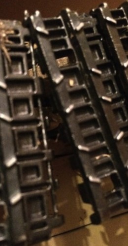

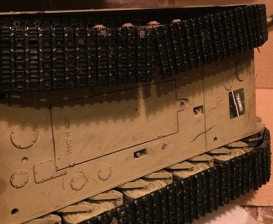

hello everyone i hope someone can help, sorry if it is an obvious question i am new to this.
i purchased a taigen king tiger tank from nitrotek a week ago for my nephew who has been using it. h has informed me.
A chain on the track has come partially loose and is unsure if this happens a lot or if it is not meant to happen, if he clicks it back together another comes loose.
does anyone know if this is ok or a fault and can give us some advice.
thanks paul
thanks paul

Re: Taigen King Tiger loose chain
Hello,
The track pin doesn't look bent so I think this is as Jake said. Make sure that the track segments are aligned correctly and that the pin goes all of the way through and use a couple of drops of Loctite to secure it.
Looks like he broke one link of track... looks like where there should be loops for the track pin to go into now has hooks reason for the "V" separation in the tracks...tell him to check the box...Taigen usually gives a lot of spare links...tell him to find the right link ...take out the pins and replace the broken links....
To take out the pins use another pin grip it with a pair of pliers or a vise grip with just a little bit of the pin sticking out...then put that end to end with the pin in the track and push it till it peeps out...the grab that with the pliers and pull it out
Tell him to be patient... it's his first time ...so don't rush the process
