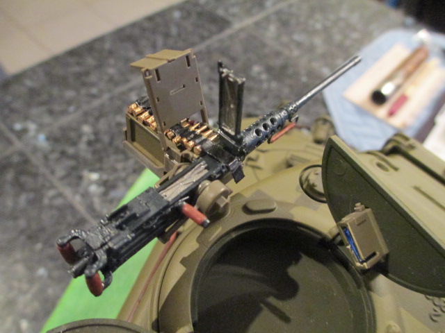

Good Morning,
Scalawag's MGs are incredibly accurate and so very close to the original depicted that they are indistinguishable. Lacking the patience of my Pal, I use Model Master's Gunmetal Blue and Dullcoat then brush with a weathering silver from Tamiya. I don't have a picture of an MG-34 laying around but 'In The Mood's .50 cal is a pretty good approximation.

Hi painless, and thanks for the compliment on the MG34s. That model masters gunmetal blue looks interesting, I will have get some of that to try I think.
