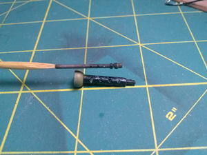

Roughen the end that is to be the muzzle with a file or sandpaper.  Apply a glob of solder around the end,
Carefully chuck up the tube in a drill or moto-tool.  Spin the tube and use a file to shape the solder into a flash suppressor.
Mark and drill holes if required to simulate vents. one the hole are drilled use your bits to remove any burrs left on the inside of the brass barrel.
I use BLACKEN IT to chemically color my brass where required.  Makes it look like gun metal in my opinion.
From the old machine gun cut the base from the barrel.  Hollow the center of the this base out so the round end of an LED will fit inside.

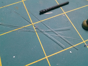

From an old Xmas tree cut some strands of fiber optic material.  Insert as many of these into the barrel making them flush with the breech end but extending an inch out the barrel.

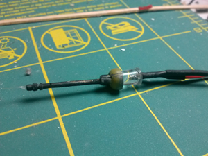

With a drop of CA glue the end of the LED into the now hollow old base. Glue the barrel into a hole drilled in the opposite end of the base.
Solder and heat shrink your connections. Then heat shrink the LED to the housing.
Insert glue and there you go!!
