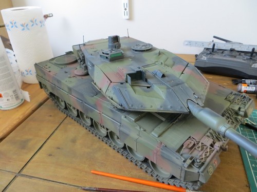

What will change the appearance is the filters and finish. Leo2a6 have a satin, almost gloss appearance underneath all the dust. The camouflage layer on a scale tank is just the first step in it's appearance. The NATO green is a dark color but it's lightened during the final dusting phase many apply to their modern tanks.
Check out my Leo 2 build and see how the paint went from light, to dark to light again as I applied filters, oils then dusted it.

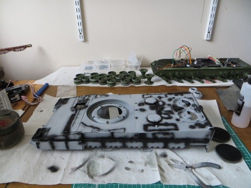

Primer & preshade
First layer of NATO green (same Tamiya type you're using) and the start of the second brown layer.

Also, don't forget the when a photo is taken, light affects it.

Primer & preshade
