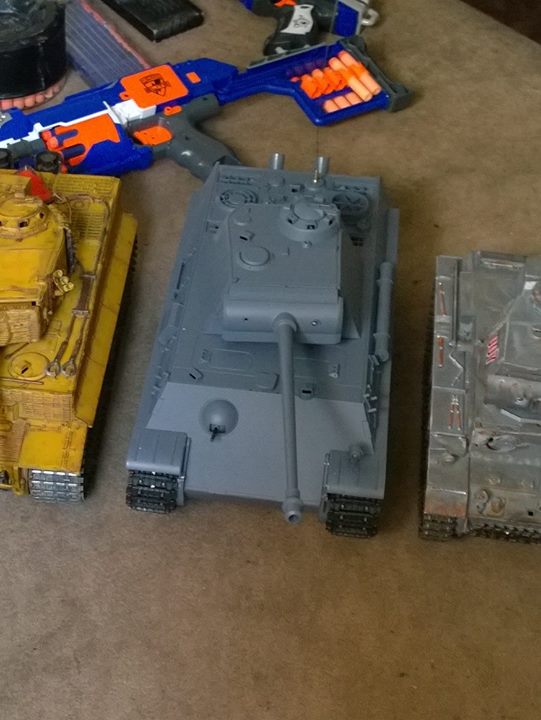

Right this is my second current build, so they might both take me a while! Aiming for a late production model here, but might skip doing Zimmerit as am not sure I can be bothered and I like the clean look! Started with a hl panther g with IR, got it from tank zone. I know they have a bad rep on here but they were actually pretty good and really helpful! So one positive review for them atleast! Going for a relativity detailed build and going to try and keep/ modify as much of the original as possible as I want to keep it quite light (my late production tiger ways about 14lb and is a right pain to lug about!) just going to add metal wheels as the rubber is removable and easier to paint, may in future add metal tracks, drive sprockets, idler, and gear boxes but this will add a ton of weight so we will see!

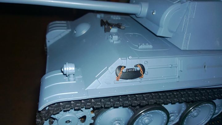

So we started with this bog standards IR smoke and sound tank, first mod was the c-hook holders and retaining pins
I used some spare dolls house screws I had from my tiger builds hinged mud flaps ( and it means i can just un screw them if I want to add Zimmerit) to attach the chains and some pins for the retainers, then I used a pin vice to drill holes in the mountings

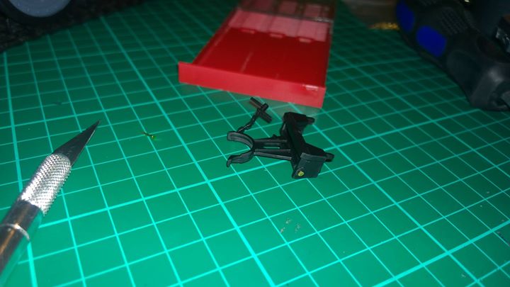

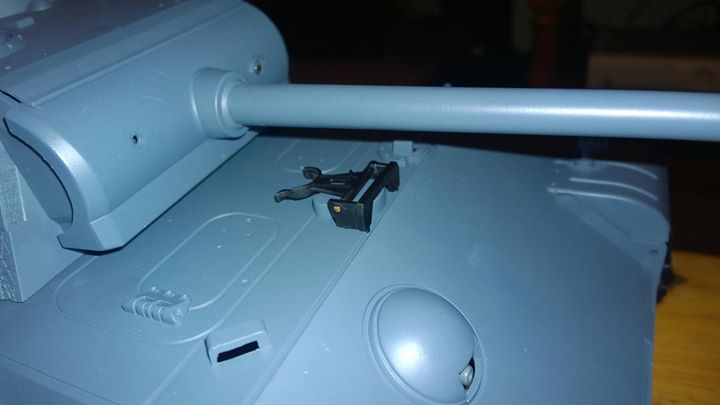

I then modified the barrel travel lock, the hl one is molded in the closed position and I wanted it to work so I drilled the end with a pin vice at the hinge point then cut through where the lock meets the mounting frame and glued some pins in for hinges, am currently using a piece of chain and a pin to hook it on too secure the barrel but am looking for a better solution for this!

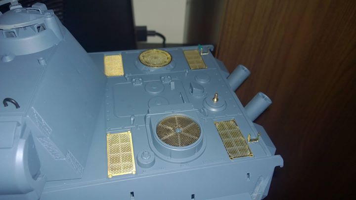

Added taigen photo etched grills and schumo tow cable clamps may add some bolts and other details at a later date

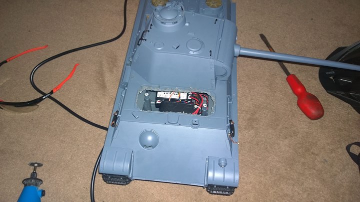

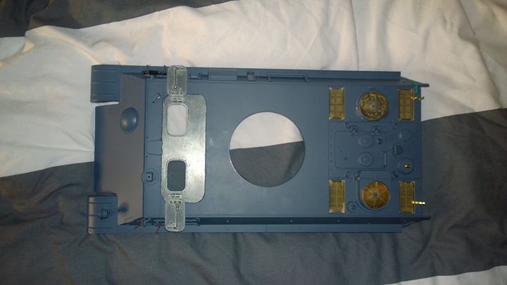

Decided I wanted working drivers/radio operators hatches the easiest way to do this is drill out the plate mounting these with a dremmal and fit a complete working metal version, I used plasticard to secure the plate/ super glue.
And this is how it looks so far!
Also added working front light/wiring, fuel over flow pipe, well lines, plate cut marks, next is going to be weld lines and track hangers which I will fabricate from plasticard.
