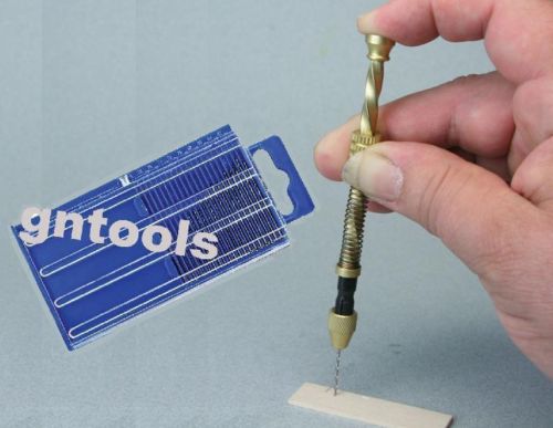

First up, the Archimedes hand drill.
Now this is where I was paying attention in class. He was a pretty cool guy right? He shouted ‘Eureka!’ whilst running down the street naked. I guess he was good at screwing (OK, a cheap joke, but we thought it was funny in those days).
Can this really be the answer? Did it take a guy who pre-dated the Romans to understand what was REALLY required to make up a 1/16 scale German WWII AA MG gun and mount? Please tell me he was right, because this answer is cheap and I have one on its way:
20PC Micro HSS Mini Drill & Archimedes Twist Drill

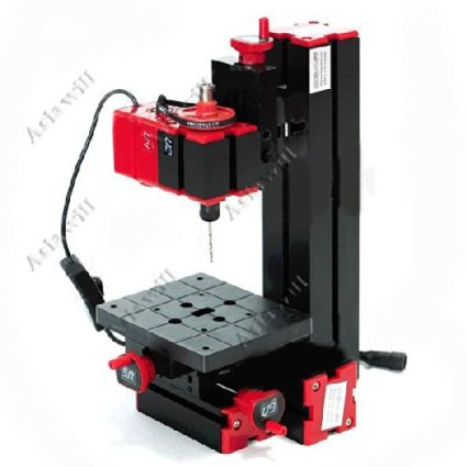

But still I have my doubts. Is it really some sort of lathe I require? Most clock in at £500 plus, but I found this one:
Professional 6 in 1 Lathe Motorized Jig-saw Grinder Driller Metal Lathe Mini Wood Lathe DIY Mini Lathe
Professional 6 in 1 Lathe Motorized Jig-saw Grinder Driller Metal Lathe Mini Wood Lathe DIY Mini Lathe.jpg
Professional 6 in 1 Lathe Motorized Jig-saw Grinder Driller Metal Lathe Mini Wood Lathe DIY Mini Lathe.jpg (23.13 KiB) Viewed 1818 times
This isn’t cheap at £177 – but it’s cheaper. Plus it appears to be coming from China. Plus I have no idea what it really does.
So can someone help me understand what I need here?

Tanks I was a bit surprised at your entry, you being my hero and all :{ I have an archimedes drill, it's ok BUT a regular PIN VICE is the answer to drilling small holes ( I spent this afternoon drilling holes in tow rope clamps so that I can fit schumo wing nuts) The value of using a pin vice is that you have total control over speed of the bit and the exact position of it, E-BAY or AMAZON have them at very cheap prices, I would suggest one that has a top that spins and a choice of chucks, It is one of the most used tools that I have. Good luck. shaun

I use two sizes of the Yankee Drill in your first illustration. One is simply a large pin vise for use with standard size bits. The key is using the right bits for white metal. You are on the right track. I drill out MG barrels and sights all of the time.

Think about it Tanks.... What does that "lathe" look like? ...Looks like a glorified drill press to me ;) I have one...99 dollars US...one drawback was the machinist vise cost as much as the drill 8O ...though even with that I do think it isn't an easy task to drill a hole in a 1/16th scale white metal MG
replacing the barrel with a brass tube would be faster ...and break less bits ...as all you would have to drill is the muzzle break...and the body of the gun...both have more "mass" so less flex when drilling ;)
Good Luck :thumbup:

TFTM, If you do buy a PIN VICE (PIN VISE in the USA) or an ARCHIMEDES DRILL you will need a lot more drill bits than you think, they are very fragile and they blunt easily. :wtf: shaun

Concur on the use of a pin vice! White metal should be easy with one. To put in context I've used one to know up the railings on the najade and that's drilling 1mm holes in 1.5mm brass rod, sounds easier than it is!

TFTM, My pin vice drilled through the schumo MG34 mount like a knife through butter and if you do any work using PE it really is vital, I think there is a bit of instructional video on using a pin vice on YOU TUBE. It will quickly become one of those tools that you wonder how you ever managed without. shaun

lposter wrote:If the part you are drilling into is cylindrical, I have had great success with the following. Take the drill bit in a drill press or any drill you have that can be mounted firmly over a vice. This can be jury rigged from a cheap hand drill drill press stand. Put the desired bit in the chuck wrong way round. Lower the drill towards the vice and then grip the end of the bit in the vice. Loosen the drill chuck to release the bit.
Now chuck up the cylindrical part. When spinning, lower the drill towards the vice mounted bit.
This has worked for me for holes down to less than 1 mm in brass and steel. The spinning part centres the drill bit itself. Its just a DIY lathe. BUt it does work.
Otherwise, an archimedes drill has always worked for me. Slow but it works.
