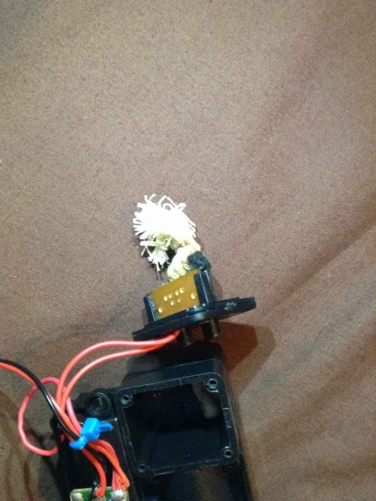

Hey there my smoke unit broke down the other day as i was use ing it and i didn't realise that it ran out of oil and burnt its insides, i opened everything up and i noticed a half burnt cotton material and two burnt wires i checked to see if it still worked but it didn't, is there a chance of repairing it????

Followed by a picture

Geese Apple....you are having a rough go with your smokers....if the burn went up your wires... that means the heat ran through the circuits... and it's probably not fixable
Sorry to be the bearer of bad news... but once again you will have to replace it

I would recommend replacing it with one of these.
http://www.rctank.de/SMOKE-UNIT-HL-NEW-VERSION_1
They seem to be more robust than the black ones. I use these in all of my tanks now.

I tend to agree with the fragility of the Heng Long smokers....it's tricky to balance the fluid... when I install a new smoker... I usually take off the cover and check if the wick is saturated... if it isn't I make sure it is...then I dry out the reserve tank.... let the residual from the wick fill the reservoir :D

Although the pages I have posted say that these are H/L they are actually have Taigen stamped on them. They have a less delicate element and do to me seem much more robust. They are still prone to overfilling, but I do find them much much more reliable. They are quieter than the black ones too which is a bonus.
I think the proportional board is the same as the H/L one you already have so you might be able to save yourself a few quid by buying the basic ones and using the proportional control boards you have. I think it should work.
