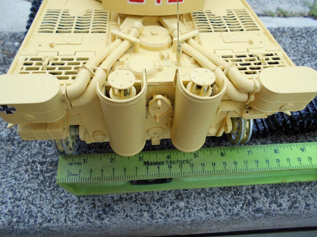

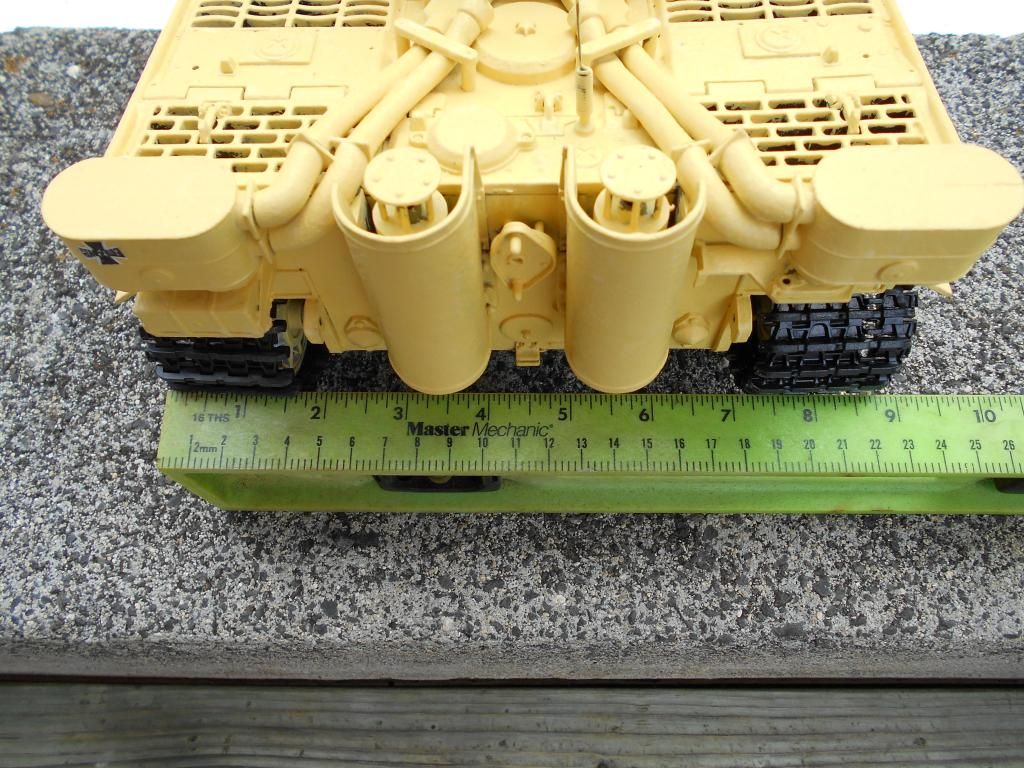

Hey Alpha would you mind taking a pic or 2 of your tracks and how they sit on the idlers? Best view would be with the mudflaps removed looking downward from above. I think I know what my Tigers problem is but I would like to see another one before I start cutting. I think the right side rear idler was installed at an angle, swept forward toward the road wheels. When the tracks are on the right side is not straight when viewed from above its canted toward the outside of the tank, the left one is too but not as bad. I may have to remove the mounting part where the screw goes in, put on a new piece and redrill the holes.

Thanks Alpha, going to measure mine and see if its the same. Wife will be home today pics of mine will be up shortly.
