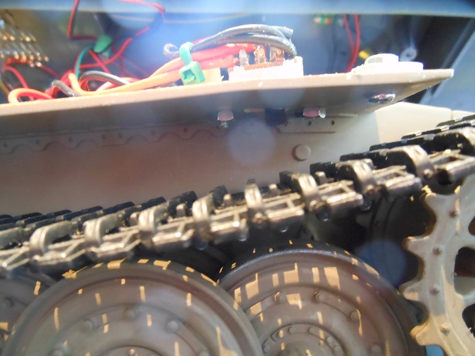

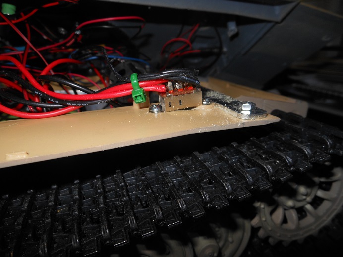

Marc,
This is what I did to mine. I have the Taigen lower hull but the upper doesn't have an open gunner's hatch and I was too cheap and too lazy to try to open it.
The mounting nut protects it from catching anything, and I make sure that "On" is when it is push back so there is no accidental turning it off if the track caught something along the way.
