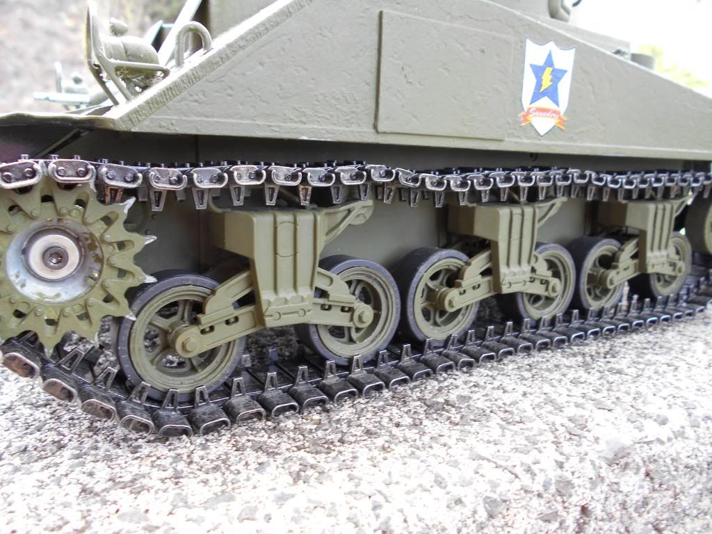

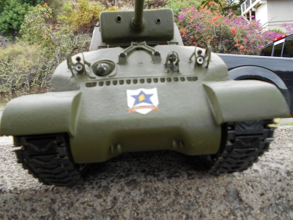

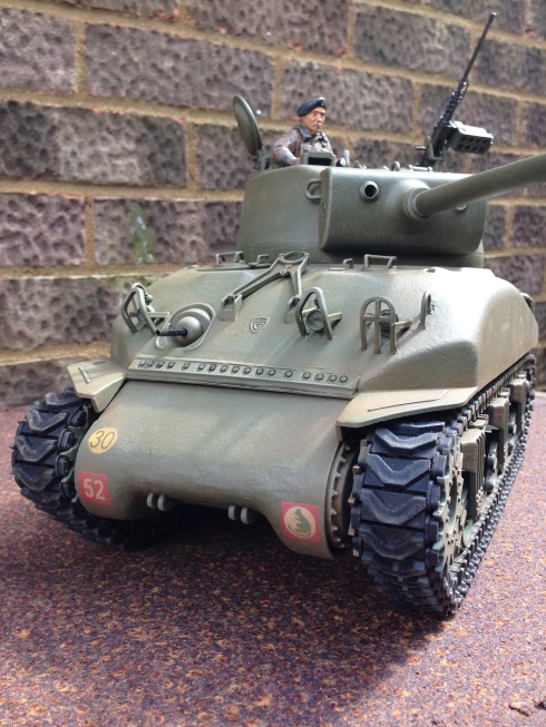

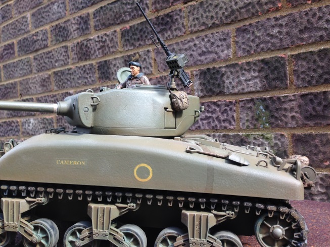

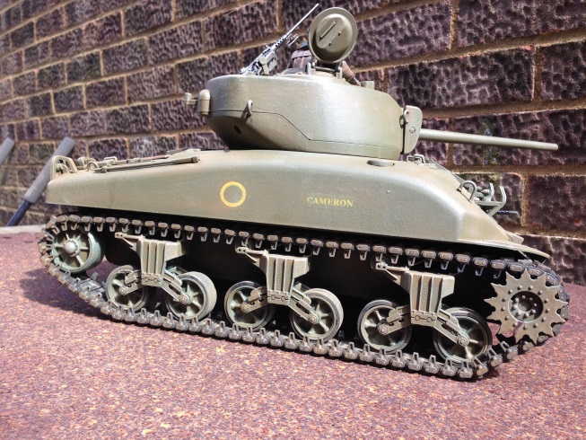

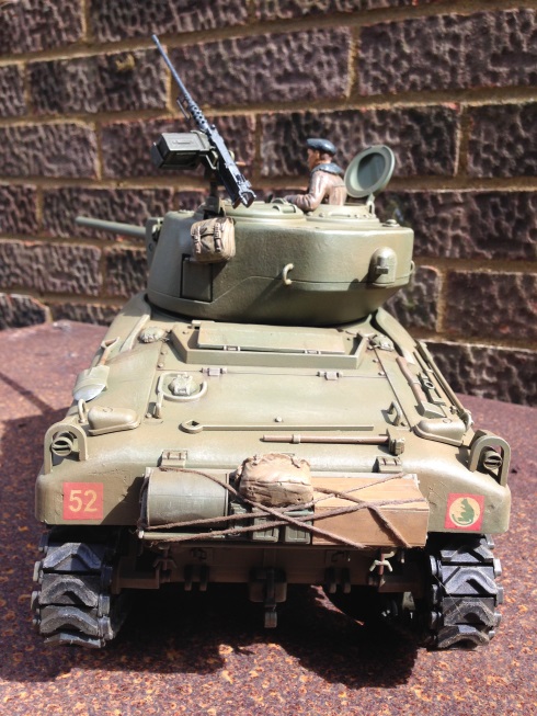

Hi all, just completed my Sherman IIa yesterday, so thought it about time i posted some pix here.
It started out as a standard Mato M4a1(76) with all the usual faults.
Work done on this baby was a little more that i had planned, but worth it.
Replaced the gun barrel.
Replaced the plastic 'ROCKER' suspension with the metal set.
Replaced the hull mg.
Rebuilt the interior, cut out the battery tray and fitted magnets instead of screws to hold the hull together.
Fitted a Tamiya system with recoil and a battle system.
Fixed the front tranny housing.
Lowered the turret to correct height.
Replaced the front light guards and lift hooks with some HL ones which are finer.
Replaced front & rear lights with a metal set.
Designed & printed my own transfers.
This tank is based on a real Sherman IIA called 'CAMERON' from "C" Squadron 2RTR, 7th Armoured Brigade based in Italy in Late1944.
Here are some photos of my completed tank.

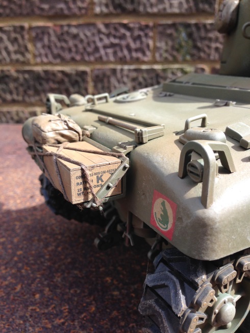

interesting configuration on the headlights/ horn...hate to sound over critical... but is that separation on the transmission plate intentional? Putting a plate on the upper hull and moving all your magnets to the rear might help for a cleaner look
Over all a decent job... how did you like working with the Mato ?
Swamprat33
Posts: 241
Joined: Wed Aug 29, 2012 10:48 pm
Location: Milton Keynes Area
Re: British Sherman IIA - Italy 1944
Post by Swamprat33 »
Hi Alpha, the tranny plate was almost the trickiest bit of the conversion and I am not sure if I'd do it that way again.
The join is only noticeable if you look from a very low angle.
Tim

Hi Tim... I merged a Mato to a Heng Long... the transmission cover was complicated... but I did find a viable solution
as you can see there is no gap ...I had to combine the Heng long with the Mato but the merging was perfect and relatively easy
Is it because of your gearboxes or electricals...like I said ...I really don't want to come of as being too critical..but personally I couldn't live with my tank with a gap showing...it kind of takes away from the other labors you put into your model...which I can clearly see has been done
Anyway... no offense meant... just something I rather say than not comment at all ;)
