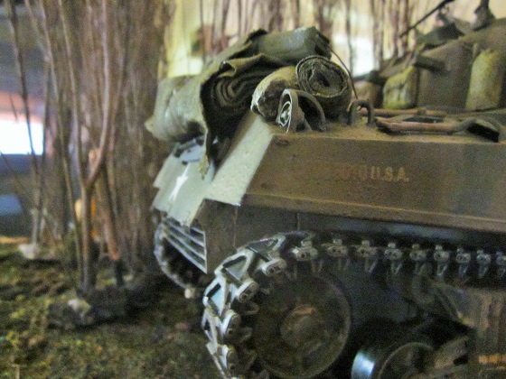

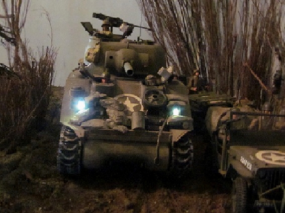

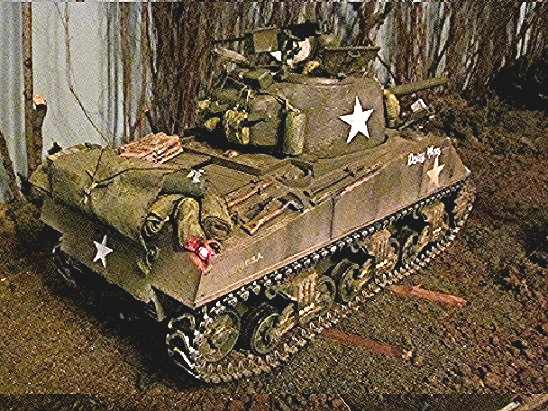

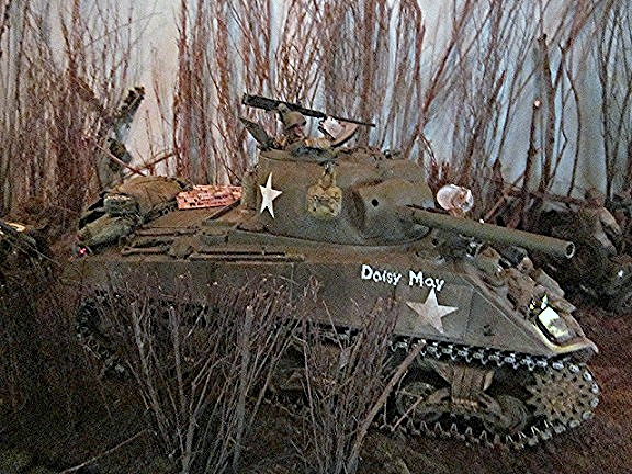

Finally got around to taking some pictures of my dry storage mid production m4E3. It has a HL lower a metal FOV upper and some added detailing.

Got any close ups... interested to see how you dealt with the exhaust

I cut the diffuser from the HL upper and attached it in a slightly up position. I had ground out the back of it just enough to open the vents
and added styrene sides to it ( in the pictures I've seen these appear to be correct ) and force the smoke from the exhausts to exit via the
diffuser vents. Make sure to attach these sides only to the diffuser and the metal hull top and not the HL lower hull rear bulkhead.
I looked at your build and it came out really nice. Too bad you didn't get an Aguilar mantle and barrel Like I did for my first 75 mm HL conversion. Sure made things easier. Also I think your transmission cover extends out farther than the tracks . The tracks should extend out slightly farther then the gear covers on each side if the transmission cover. When I did my Mato M4a1 I had to do a lot of fine grinding
and plastic softening in order to correct the same thing.
Sorry that the pictures aren't in order but my mouse went bye bye while I was trying to upload them and using the notebook pad is a pain.
The center one is the Mato that I redid the transmission cover on. Also for some reason when I post this its splitting up my paragraphs
but I think you can still read them.

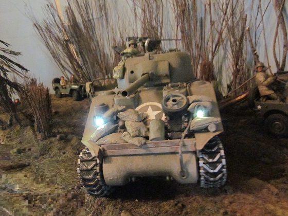

Hey GreenGiant... I did my exhausts like this.. modeled my tank after the Fisher release
I also did a Mato....Modding the transmission cover was the only way I could adapt the upper to the lower Heng Long Hull

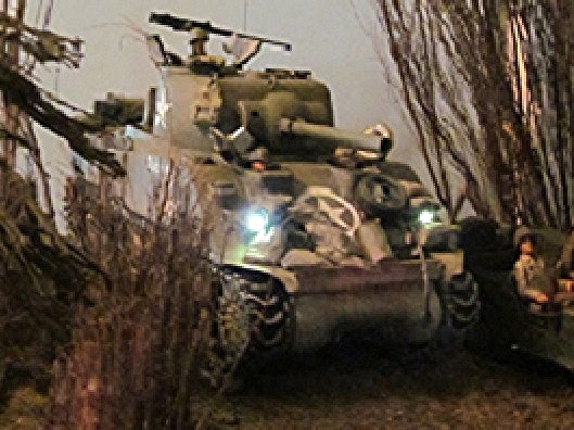

You must look at the two pictures yours and mine that show the whole tank. They are both of the same type and wet storage. Fisher produced 4614 m4a2s, 2994 m4a2's with wet storage, 3071 m4a3's with wet storage and 75 mm gun 525 with wet storage and 76mm gun. In your final picture you can see the diffuser above the exhaust in its stowed position blocking the view of the top edge of the exhaust system, your showing a post ww2 model with the conduit and large hole that a field phone was mounted to. Using the dry storage FOV upper I think you may have made a model of the M4 that never existed as I have yet to find a ww2 Photo that matches your build. But I got a new mouse today so I'll keep on looking.
