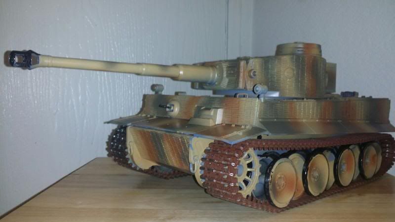

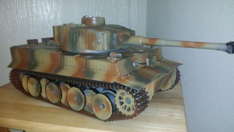

The paint looks much darker then the King tiger I did and this is mostly a happy accident. It looks much more authentic. Sometimes cutting corners is actually useful. The pictures help show me what the airbrush missed-quite a lot really. After seeing these photos I went back and touched up a lot of the grey with more sand gel and a paint brush...The camp stripes are really too wide! If I touch up with the airbrush again it will be the last time if i botch that I'll have to start over!
The way I did it might be helpful to know if your model paint jobs are coming out too bright...i started with a grey primer. then i airbrushed "sand gelb" over that. I didn't cover the grey completely with the sand, a lot of the grey shows through and that is fine. Then i did the rest of the camo and the overall effect is very pleasing. The zimmerit is from Welsh Dragon.
