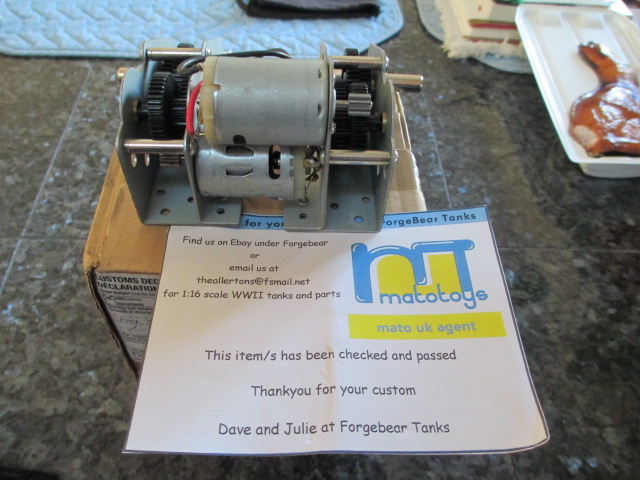

Got a pair of the black steel gearboxes in from Dave at Forgebear for 'Maxene'. The tank came with the white metal set and a better pair of boxes was something I wanted to add after the M4A1 redo was complete. Well, the M4A1 is pretty much finished up as of last night and the gearboxes showed up in the post today. Pretty good timing. I also have a resin box and ammo set for the .50 cal and I want to do a mod for the HL metal idlers that Sassgrunt suggested. This is all regular stuff and should be done well before the arrival of the KV-2 parts I have started to collect.. I'll try to show the improvements as they go. Pictures:
Should be an improvement over the white metal gearboxes
M4A3 (105) black steel boxes from Forgebear

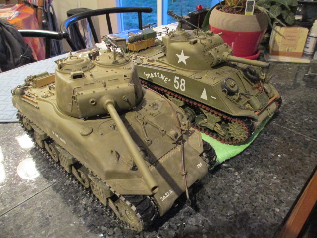

I'll keep that in mind, Alpha. ;o) I'll have Mike give me a demo while he is here. ;o) I had errands to run after work today so all I did upon coming home was get out the charger to give both of the Shermans a full charge to show off with this weekend. A quick picture to show both side by side.
In The Mood and Maxene

PainlessWolf wrote:I'll keep that in mind, Alpha. ;o) I'll have Mike give me a demo while he is here. ;o) I had errands to run after work today so all I did upon coming home was get out the charger to give both of the Shermans a full charge to show off with this weekend. A quick picture to show both side by side.
Now that's a great shot Painless.... it really highlights the weathering you did :clap:
But isn't this Maxene's thread :think: ........ :haha: :haha: :haha: :haha: :haha: ...no worries... I'll keep it under my hat :D

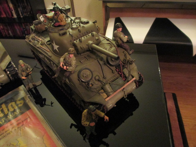

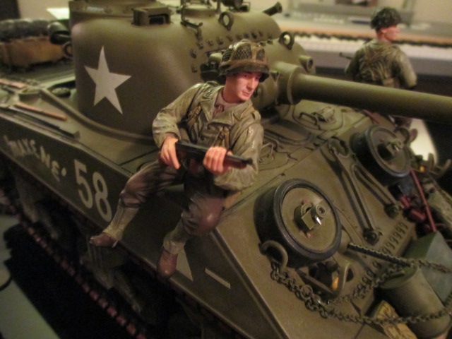

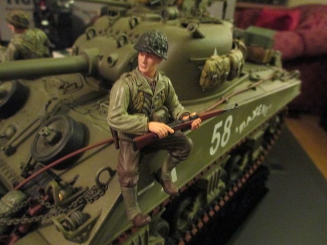

*chuckles* Sorry to make you wait, my Friend. ;o) Today was a day for tanks tho'. The black steel gear boxes were a direct drop in for 'Maxene' and tremendously improved the handling and control of the tank. I took the time to count links on both tracks and make sure that there were the same amount on both. There were but I did find a couple of reversed links on one which I corrected. The sprockets on these gearboxes sit a little bit forward as opposed to the ones I replaced so I left the idlers and number of links of the track alone. Finally, I took the time to clean up and add a couple of really cool items that shipped in with Sassgrunt from Hawaii. Pictures:
2nd Sherman thread of the day...done
Not a happy fella' even after I repaired his BAR
ditto for the Driver's side
A new addition to the tank
'Maxene' redone
'Maxene' redone
