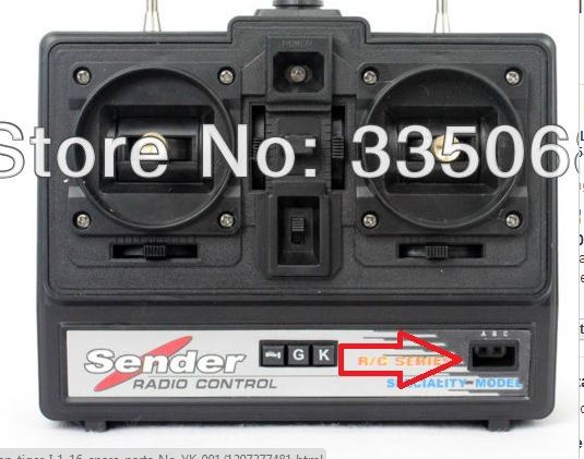

Image above shows the NON smoke and sound transmitter. This one works with HL tanks which will be fitted inside with the circuit board designated "TK01" (it says as much right on the board). The visible difference is it has a switch, shown by arrow, to change frequencies.

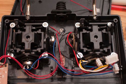

And here's what you will see if you try to take the transmitter apart:
Ready to try to tear into that and fix it? Neither am I! New ones are $30 on aliexpress...
