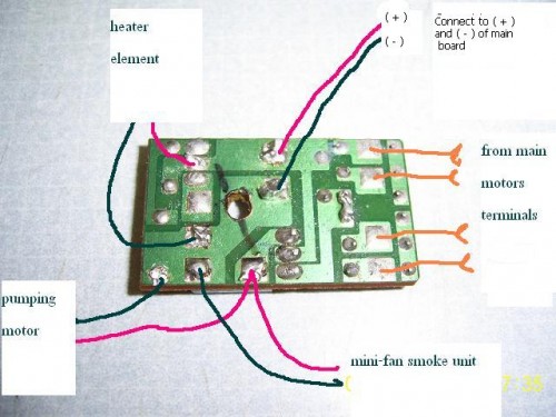

The four open square solder point needs to be connected up to the motor wires. You need to snip/split one wire from each motor and then solder them to the four square solder points. Basically the idea is that the more juice goes to the motors, the more power drives the smoker and supposedly more smoke will be generated. This is what I have but I have no idea where it came from and not responsible for any damages to your tank..........

Re: Proportional smoke units... how to connect them?
This is great guys thanks, just what I wanted. God knows how I missed the bit in the lecy section
I have a HL Sherman stripped down for a Firefly project so I just swapped the standard smoker plug over with this one and fired it all up... was a little concerned that the pump didn't move but then remembered reading somewhere it needs the wiring to the motors to get the "proportional" input. Makes sense when I think about it now. I'm planning to eventually swap the noisy, pants pump for a mini fan but I'll get it working first before trying anything too clever.

There is a thread... I actually asked a similar question...more regarding how they worked and if they were good... I've bought four to date...have installed three...basically plugging it into the normal port on the RX ...how I found it works is.. at no movement idle it will smoke..a little throttle the pump begins to move...as you move..it pumps more like normal.. once you hit a certain speed it shuts down so there is less current draw when you are at speed..thus prolonging the life of your battery charge

Painless... for your Mato... what you might want to do is wire the smoker directly to your on/off switch or.. directly to your battery with an on /off switch on the Positive lead ...you could also go the route of getting a secondary small lipo and run a separate unit all together ..it's the usual hook up for the super high grade aluminum bodied super smokers..as hooking them into the RX could cause heat problems...not to mention draw heavily on the batteries

Thanks for that discription Alpha, helps me plan my build. So is it possible to sit still for a while building up smoke and then nail the throttle and get a nice big cloud out the back as you move off? That's what I'm aiming for. I'm thinking to remove the pump and build a smoke box around the existing box. Wire the fan into the old pump electrics and maybe include a simple flap valve to stop the smoke leaking out when the fan isn't running.
