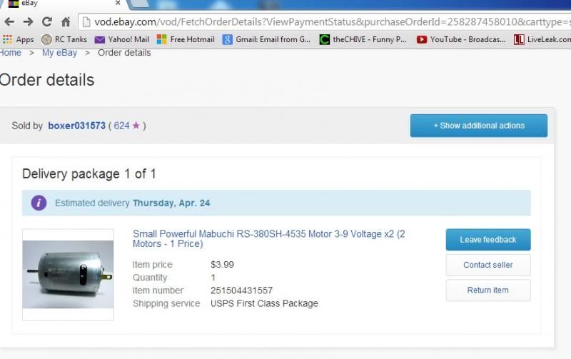

Thats ok Shaun, I have noticed that r/c tanks are just not nearly as popular in the US as they are in England and the continent...there are plenty of places to buy model cars and helicopters, and lots of shops with every single part for same, for a hundred different brands and types wall-to-wall... but ask the clerks there about r/c tanks or getting parts and they know absolutely nothing about them and care even less. Cars and helicopters is all they know and the shops, even chains like "hobby people" have no interest in stocking the stuff either.
i just ordered these things for $10/2...hopefully they will work in the steel gearbox
