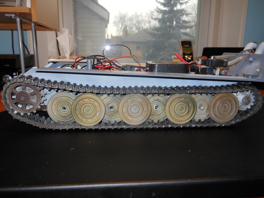

Jnewboy, I spent the day hacking/cutting/drilling and this is what I ended up with:
I kept the HL Panther swing arms, but have to drill out all the HL Late Tiger wheels and put in 9/32" alum tube as the new axle. They slide right over the Panther swing arms, and the outer road wheel and the caps (I didn't put the caps on to show the new axles) will fit right over with a slight push/pressure. This baby is not going to be a runner but I did test it out quickly and it runs okay which I am fine with. Now I just need to get the rest of the parts.
MichaelC.

Looks Great!! This will be fun to watch! looks great so far!!
