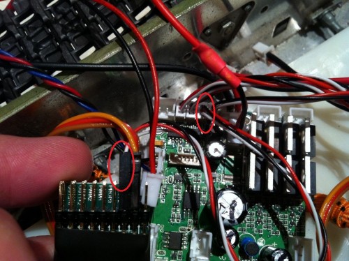

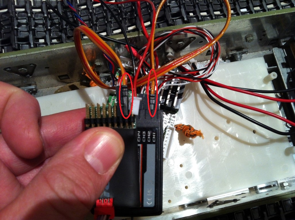

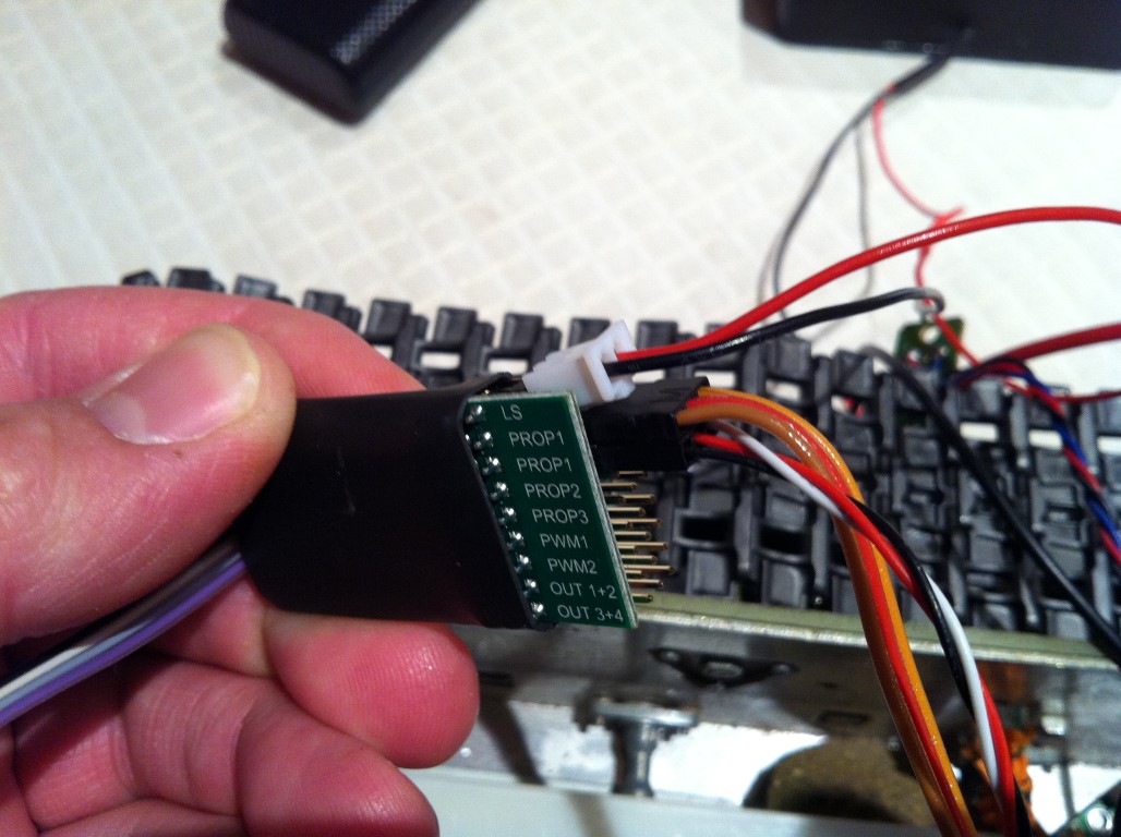

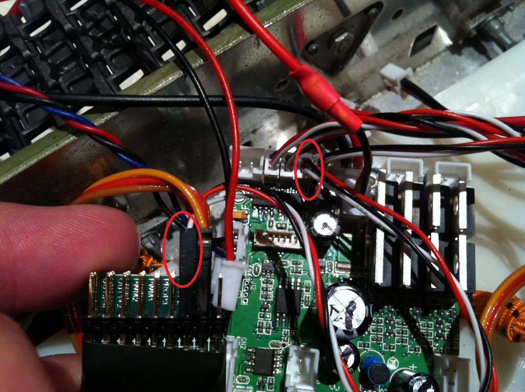

Here is how I have my Clark ( kv) + tbs mini unit .

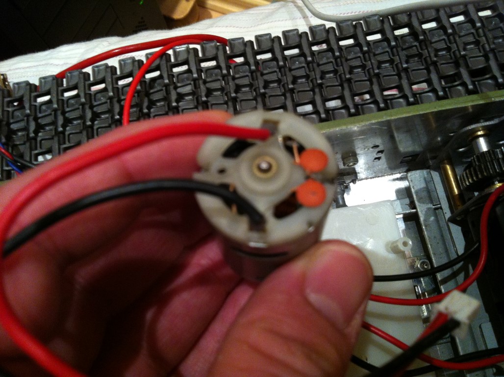

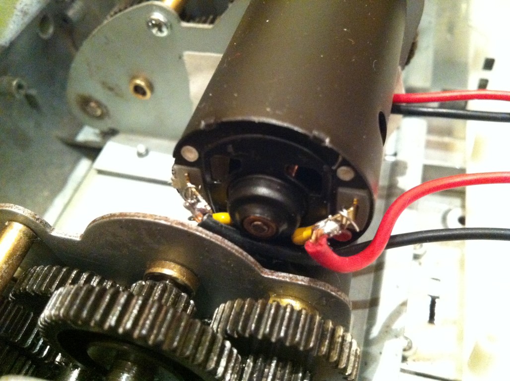

and on my Stock HL motor + on the promax black I have these caps

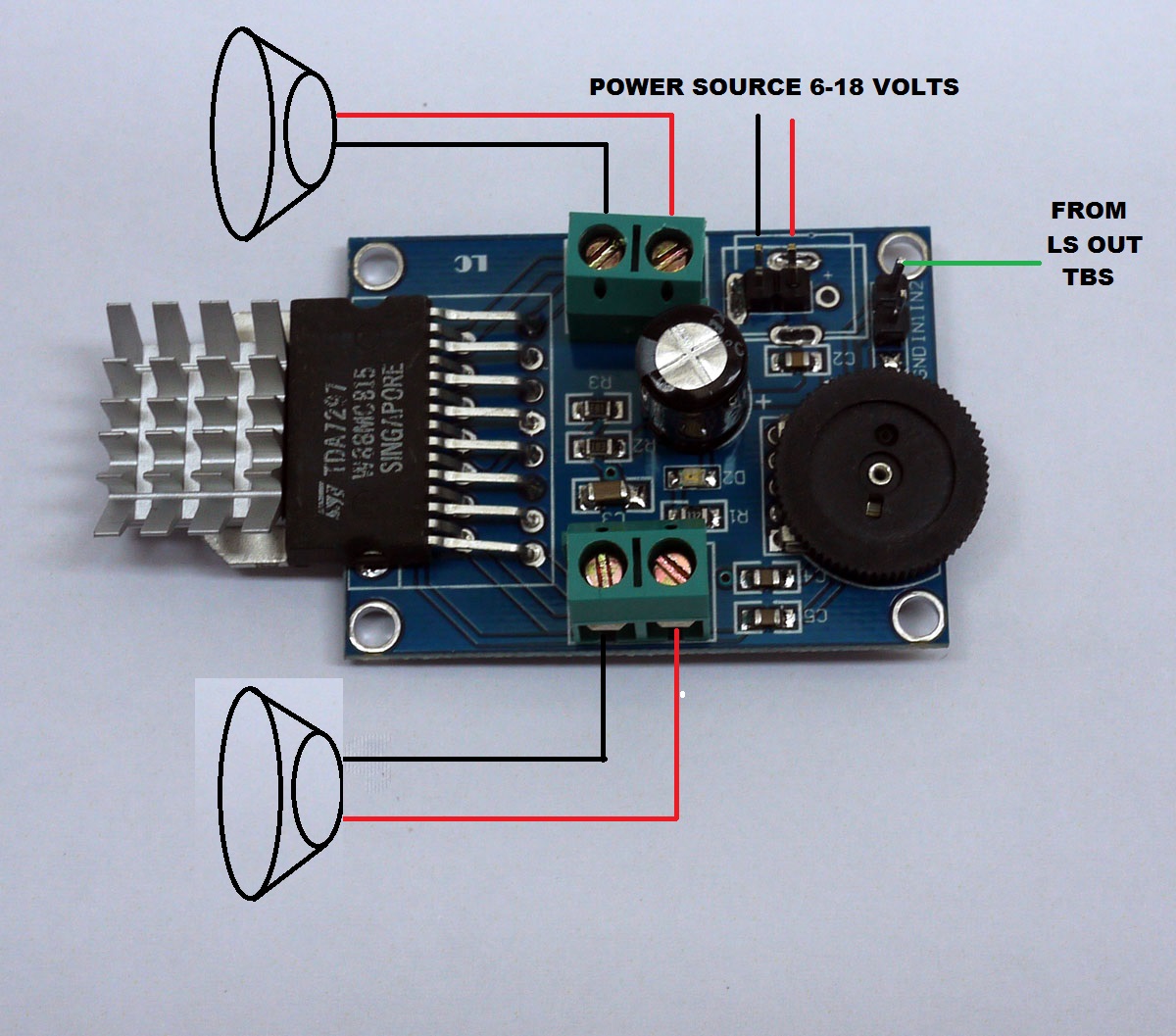

for getting the Clark sounds ,on canon, turret and canon movement, just plug a hl speaker to the speaker out on Clark board( i think) I'm awaiting a amp from Dan to try out for the speaker I have. Since it is the viaston fr7 4 ohm the tbs mini is getting hotter tha hell.
