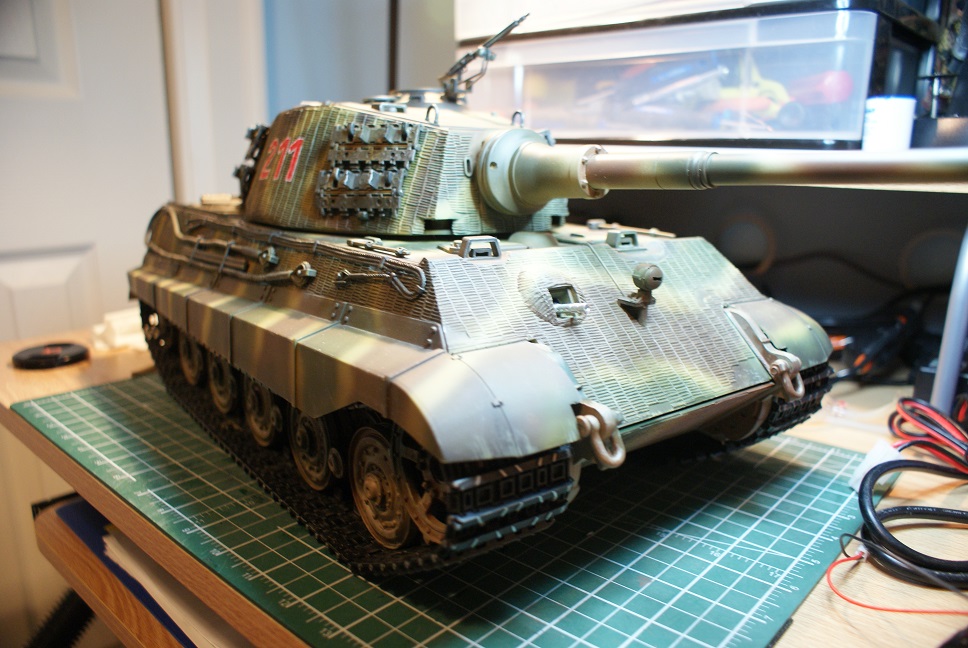

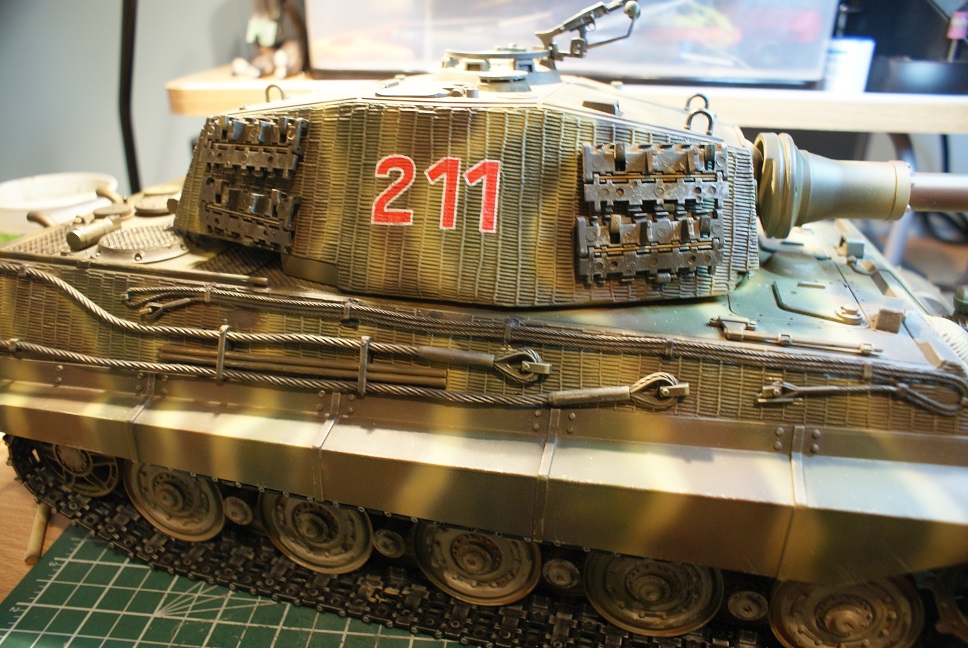

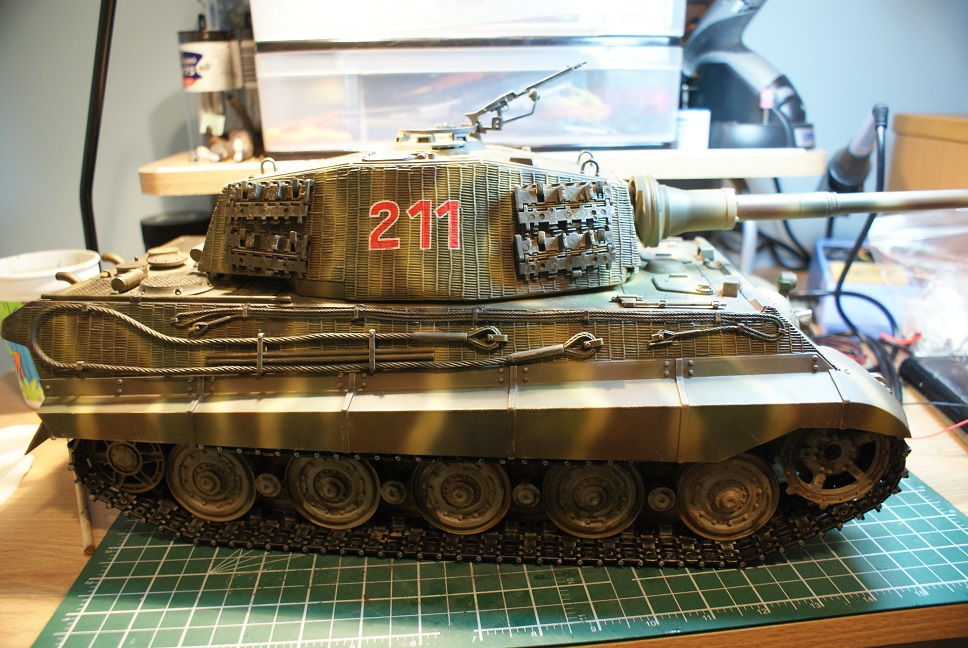

Hi all,
Been working on one of my earlier collection, a Matorro/Heng Feng KT. Bought it pre HL KT, so it was the only game in town. Crappy version of HL electronics, WSNish gearbox so basically a shell. Upgraded it to RX-18/ Brass gearbox and then Clark but the chassis is just too weak. So my latest project has been trying to fit it to the excellent Torro KT chassis. Have to keep the back plate, but overall I am quite happy with the fit and now the Matorro KT finally comes to life !

Good Evening,
Those new lower hulls with complete suspensions are a boon to any tanker wanting to upgrade the performance of his HL or Matorro tank. Great job on getting your King Tiger up and really running.

Great work mate.... I have had one of those torro kt hulls and they are a nice bit of kit.....
Great looking kt by the way......

Shaun, I have to fess up....... Believe it or not this is the paint job it came with, along with the molded zim. I have to say that it is the most impressive of all my tanks out of the box. These days they would call this custom paint job and charge you an arm and a leg. I think Matarro spent all their money on the paint job and the molded zims and forgot about the electronics and the mechanical stuff.jarndice wrote:Michael I would take Painlesses advice, we all know that at least once in the ownership of a Tank it will get (say it softly) dropped, and after the first bout of bad language the realisation that you no longer have the old KT body to help in the repair will evoke even more bad language. so if only for some dacorum keep the old bodies. and in an era of being urged to be "Green" you are to be applauded in the recycling of your Tanks! nice paint job by the way. shaun
Marc, the Torro metal hull (and the Taigen lower hulls) are more than just the metal tub. They came with torsion bar suspension like the real deal, metal road wheels on bearings, idlers with tensioners, plastic plate for mounting all the hardware and integrated on/off switches and upper hull locking mechanism. Compared to the HLs out of the box it is a completely different level of tanks. The additional weight is usually offset with the better suspension and also upgraded gears (the one I got from WDM is suppose to be 5:1 but I think it is more like 4:1) so literally you go from a toy plastic tank to an almost all metal, weighted beast. The only thing that is missing in my mind is drive shaft support with bushes.
