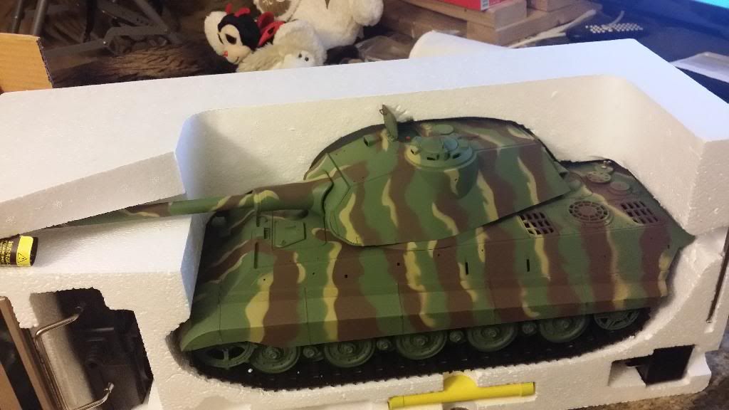

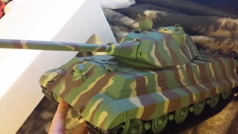

It arrived only 4 days after i ordered it. I guess i will start a blog, this being the first post! My plans are, at first, just change to the steel gearbox, steel idler gears, and steel drive sprocket. The parts on the way. Maybe add track tensioner, the henntech is pricey though, might make some myself.
-Ball bearings in the idler gear and the drive sprocket-to support the drive sprocket especially. Undecided exactly how i will do this yet.
=Repaint the tank mid to late 1944 scheme, with dunkelgelb base and the usual red brown and green airbrushed in the ambush pattern. Still undecided about zimmerit, i might just forego that. If i decide to go with it i will put it on myself, no zimmerit kit...PRICEY.
The object of this to me, is to get the best tank for the least money over all.
The battery is still charging for another 3 hours - the internet says 4 hours 15 minutes, and to use a so all i've done so far is admire it...this is my HL King tiger, there are many like it but this one is mine
