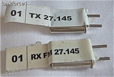

Hey giys thanks for the advice could i use these crystals
Posts: 8466
Re: Starting my tank up
Hi Applelover, those are exactly what you need. take care. shaun

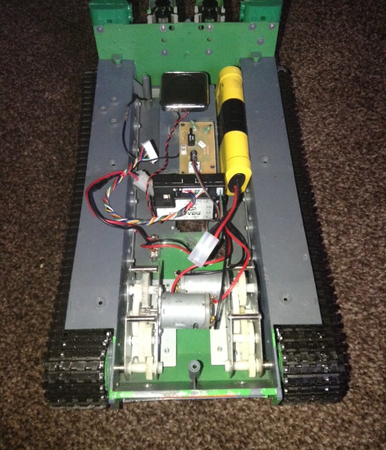

And this is the tank that im working on so could anyone who knows about tanks help me ASAP thanks

Hi shaun by the way look at my tank picture is all the stuff ok is there something i need
Posts: 8466
Hallo again, You appear to have a complete Heng Long Tiger 1 hull, it seems ok but you would need to show the upper hull and turret both external and internally, I would suggest you look at some of the Tiger 1 builds on the Heng Long builds site on the forum, you will find a lot of helpful photographs showing all views of the tank layout which you can use to compare with your Tiger 1. Good luck. shaun
