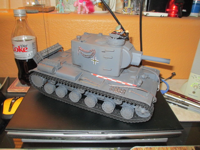

Next up: Some color schemes on existing models of both the the stock Soviet tank and the German 'Capture' version. I plan on building the 'Capture' version but it is early days yet and paint on an armored vehicle is the easiest thing to change or leave alone in the case of the Wehrmacht using these vehicles in the Malta and Greece campaigns.

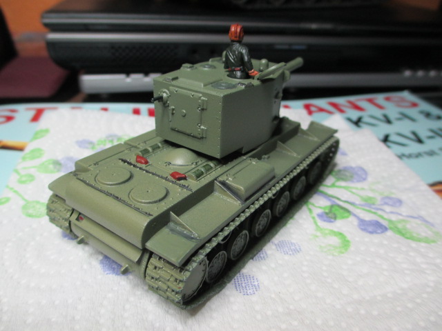

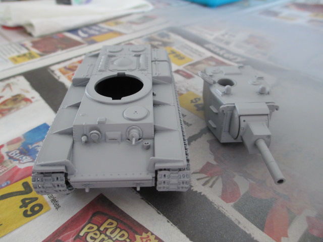

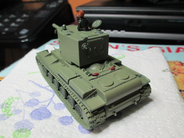

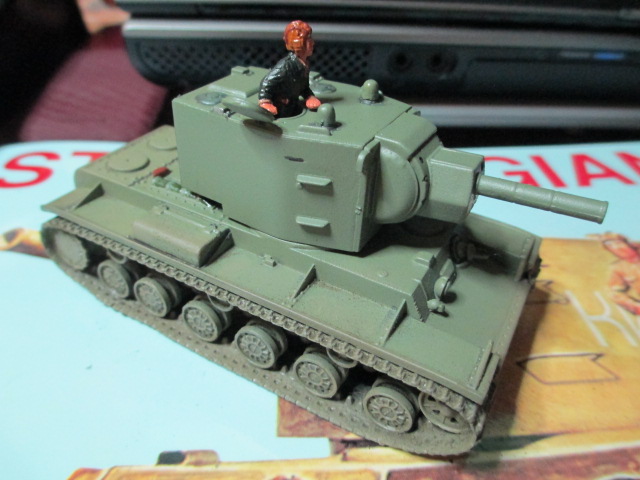

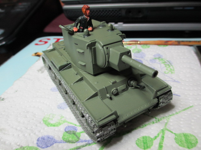

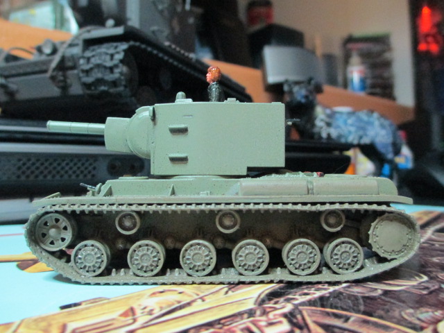

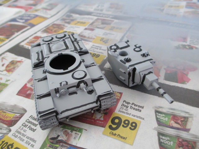

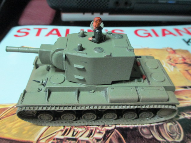

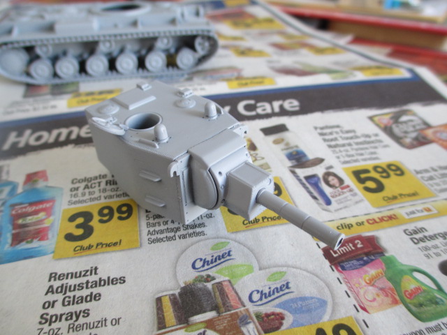

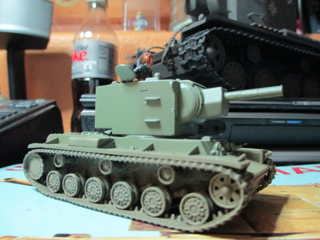

Next up: A 1/72 scale Unimax model I built last week and considered several paint schemes before going with the basic Soviet pea green with mud weathering. I painted, detailed and weathered this small version of the giant KV-2A in a marathon seven hour session yesterday (Sunday) The primer is Tamiya's excellent grey and the spray color was Testor's Bomber Green flat. This was as close as I could come to color images of this vehicle with it's standard paint applied. Normal shadowing was performed while the tank was in primer then a pin wash of 50\50 flat black and brush cleaner was applied after the initial spray. The tracks were brush painted in steel then this was followed up by weathering with mud from Tamiya's weathering kit. The figure was painted in Testors tan flesh with Tamiya acrylic Dk Green for the coveralls and Testor's flat khaki for the uniform shirt. A leather belt w\silver buckle and two tone ( Testors flat brown and leather ) tankers helmet completed the figure. The boots were left in molded black.
- Tracks painted with Steel
- Tracks painted with Steel.JPG (98.63 KiB) Viewed 4684 times

- Initial spray1
- Initial spray1.JPG (99.54 KiB) Viewed 4684 times
- Primer 3
- Primer 3.JPG (90.47 KiB) Viewed 4684 times
- Initial build with no primer or paint applied
- Solid little KV-2A.JPG (96.18 KiB) Viewed 4684 times

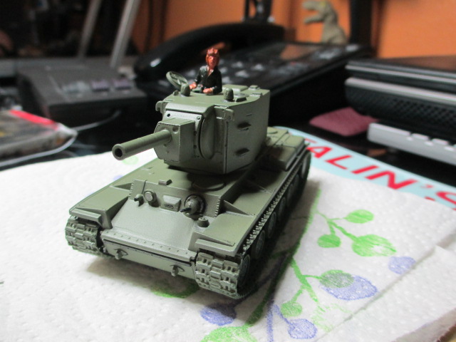

1/72 Unimax KV-2A cont:

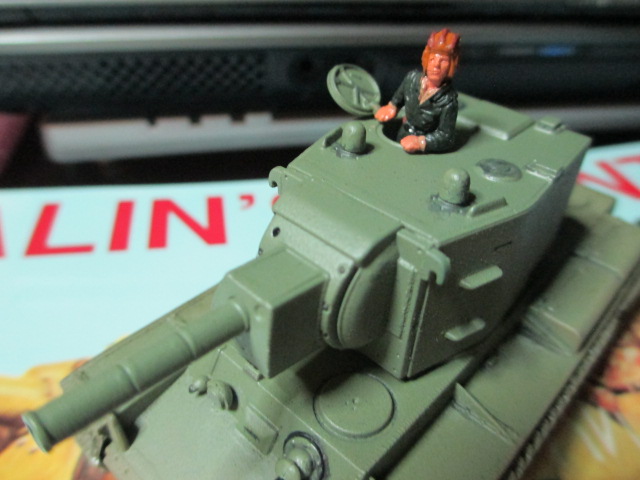

- Figure closeup
- Figure closeup.JPG (93.02 KiB) Viewed 4682 times

Re: 1941 KV-2A Research
That's the way to do it. Small scale dry run before you jump in the 1/16. Looks like plenty of research material too!!!
Pale

Hi my good friend, still keeping warm and dry I hope, Are we in for another expose on the only true path to building armour? You have no idea of the pleasure I have gotten ( do you see what American English has done to my vocabulary?) from discovering that my hero has made a MISTAKE
no no, I meant I think you might be in error sir, your second photo down of the KV2 capture in Panzer Grau, you have marked with a "BALTIC" cross, I expect that you have given the typing to one of your staff who not being aware of the complexities of German markings of WW11 thought that was what you meant! when we both know it is the Balkan cross ( Balken Kreuz ), oh the warm feeling of discovering that I actually know one thing your secretary didn't. I shall as ever be watching the progress of a challenge I think I would avoid, good luck when you can get going. take care Painless. shaun
- Posts: 7916
Good morning, Jarndice,
*Laughs* My only secretary is me in the morning at 6:00 am ;o) My mind was far away beside the Mediterranean while typing. Corrected!
