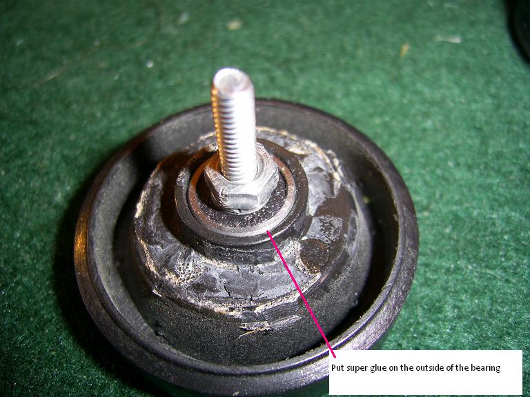

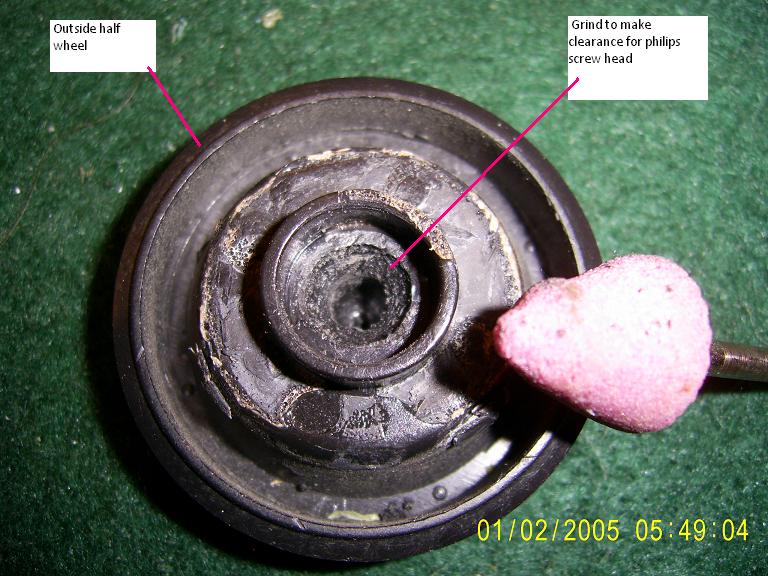

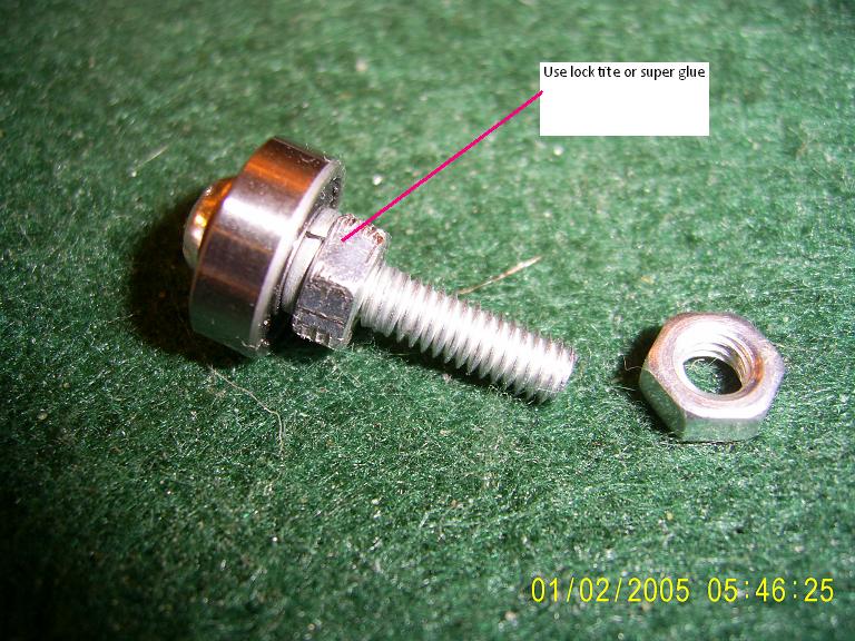

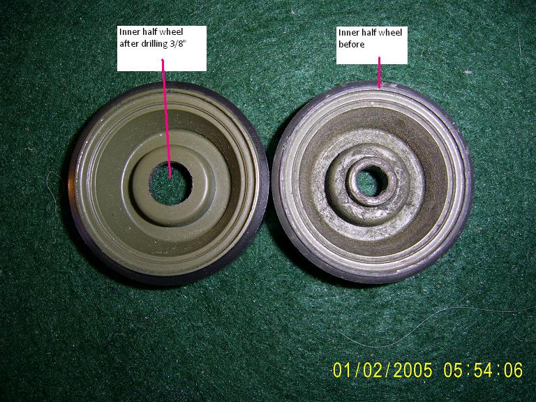

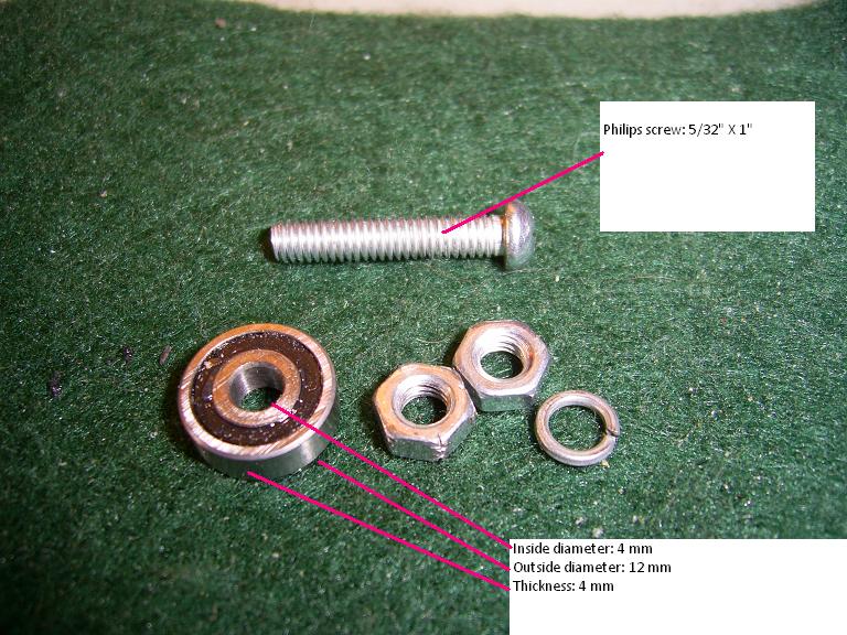

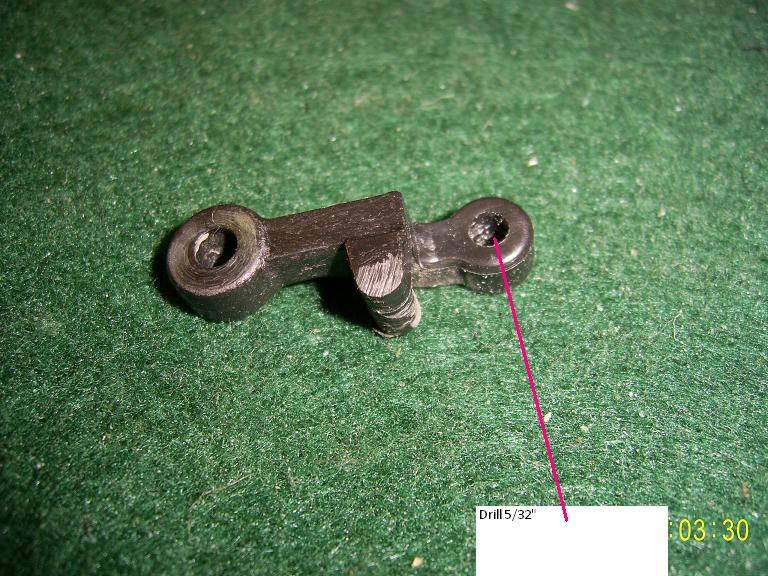

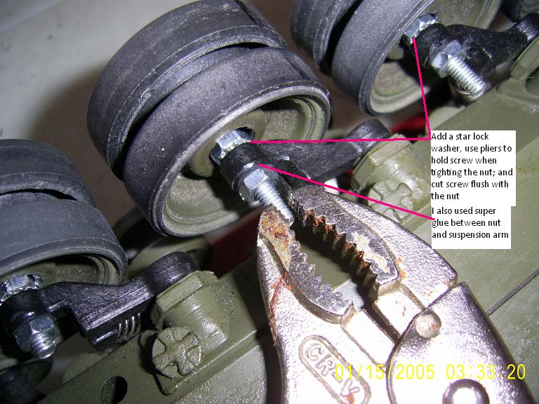

Here's a simple modification to improve the ride of a H.L. Pershing or Walker Bulldog.
We all know that, as far as metal upgrade goes; these two tanks are the neglected children of the H.L. family.
I bought the bearing from this site:http://www.ebay.ca/itm/20pcs-604-2RS-4x ... d7f&_uhb=1
Here's some pictures with commentaries to show what I've done...

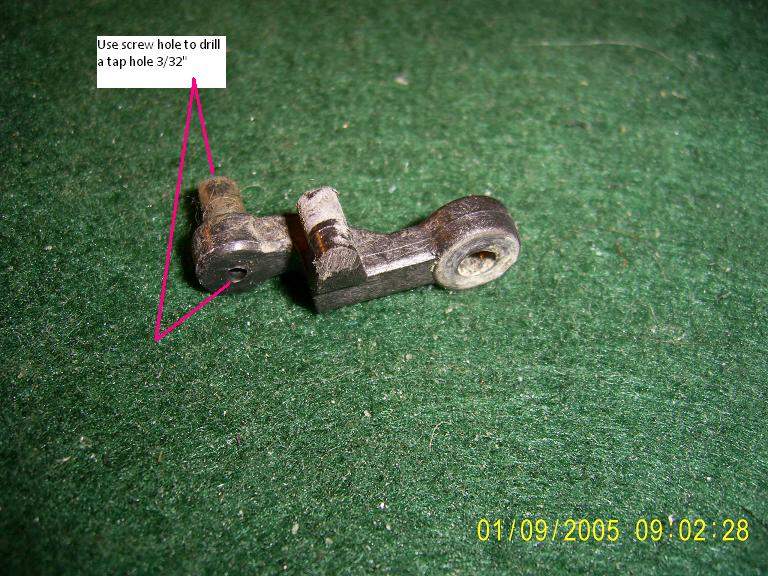

More pictures....

Hi I scratch build a lot and that looks a good simple cheap modification to carry out. I try it out on my next build using the bulldog hull. thanks for showing it.

The hard part of this mod. was to split the road wheels without breaking them... >:<
