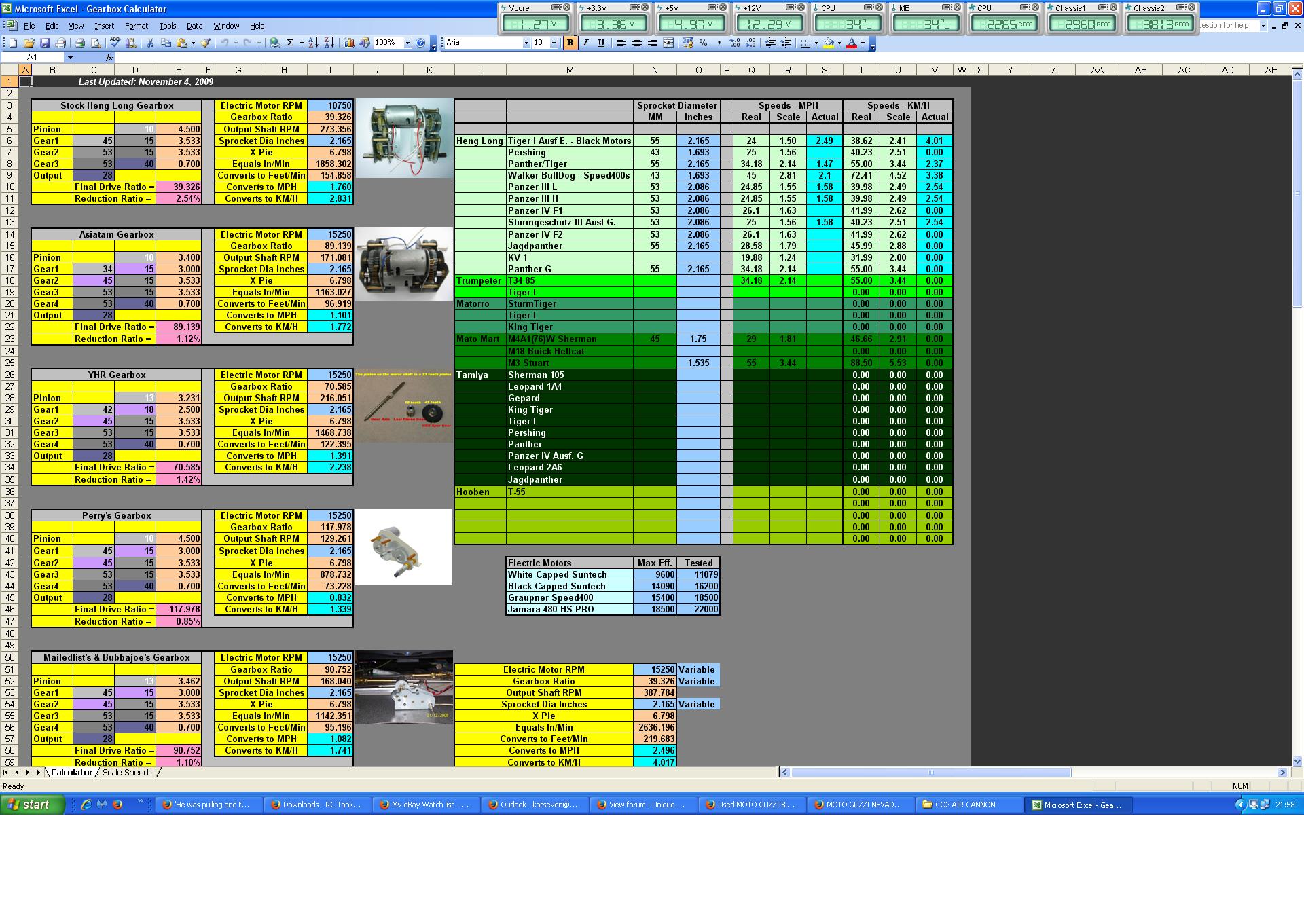

There is a gearbox calculator on the site which might help.....
The gearbox calculator is in the Download section....here is the link to the section its the 7th one down posted by MatDragon...
downloads/
It is downloadable and actually enables you to change the number of teeth on a gear and this will automatically change the results for the whole gearbox including the scale speed......
....and I think the real speed... :thumbup:
Here is a screen shot of what you will see when you down load it.... click on this image from my computer to make the image larger....and to give you a better idea.

Thank You......that is a lot of info. But it looks like it applies to already designed gearboxes. What i need toi do is design one from scratch................to fit the parameters first described above. Do you know of any calculators that would help with that process. Thanks, PP

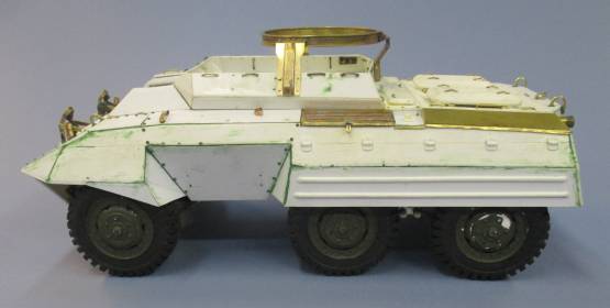

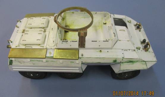

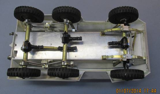

Hi Alb: The model project is a 1/16th scale US M20 Greyhound with 6 wheel drive. Since its to scale, the transfer case (TC) needs to be fairly accurate....which is quite small. Once I figure the number of gears and teeth per gear that I need, I will locate the gears....which will be similar to those found in a Tamiya gearbox. Then I will design the actual TC frane size and a friend of mine will make it out of derin hard plastic using his 3D printer. So I probably need to talk to someone who designs this type thing for a living or maybe those Robot guys might be a help.....thanks for suggesting them. Here are some pics of the model so far. The open area between the U-joints in the last picture is where the TC will come thru the bottom hull......PP
M20 underside w MG Ring.jpg (24.21 KiB) Viewed 613 times
M20 right from above w MG Ring.jpg (20.52 KiB) Viewed 613 times
M20 left w MG Ring.jpg (16.89 KiB) Viewed 613 times

Thanks for the photo ..it looks really good....
Just to make things a bit more simple.. ( and I know that its not 'Correct' )... how about just going with 4 wheel drive to the rear wheels ??
It will be much easier and will make VERY little difference to the way that the vehicle goes.... Especially since you have put so much time into building it you are hardly likely to be crashing it through bushes and rolling it over...The front prop shaft will still turn.. you just tie it up out of the way...
Getting a 4x4 gearbox will be so much easier and you will have a better space to put it in.....
