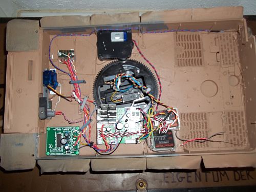

Well done Herr Fritz, that is a sweet looking and sounding T1. I like the idea with hull MG, how did you go about setting it up inside and with the controller? Great job dude...

I used a second Receiver and plugged the mini servo into the aileron port.....so
when the Tank is NOT in motion I can use the left stick L & R motion to aim the gun.
The 1st Receiver powers the 2nd receiver ...I am not very experienced with transmitters
so I messed around till I found a way to make it happen.

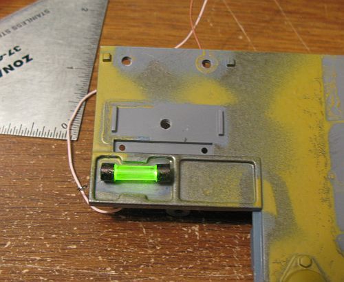

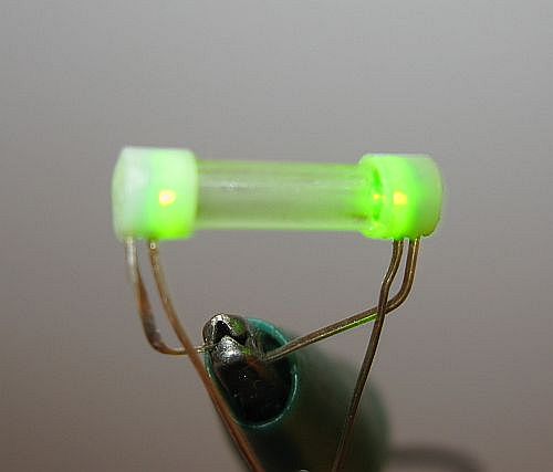

Here is what I did with the rear formation light...its real glass from a camera flash tube.
http://youtu.be/0yWBmuAK8rc

that Haunted machine gun is really something else...and thanks for showing us your very well thought out wiring ...it is as clean as you described in your other post
better than I had imagined :D

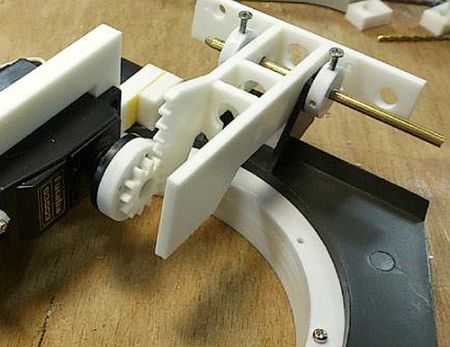

Now for the Barrel elevation gearing I am using the large gear parts from two
Heng Long airsoft shooter mechanisms to build something similar to what I have seen on
the net and in Clarks Site.
At the moment my elevation thingamajig is just a servo wing and at the end of it is a ball like
thingy that rides in a channel connected the the other side of the recoil thing ...you know ...that doohickey thing :wtf:
NOT MY PIC...its from the CLARK MODEL PAGE
