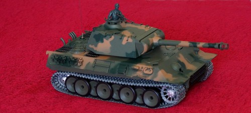

Yes the pantiger arrived today,first impression wasn't bad but not good either.. The Camo on it looks like it shouldn't be there it has metal tracks but both the drive wheel and idler wheel are made of plastic and on one side the track wants to come of the idler wheel, tried to reinstall the idler wheel but still wants to come off so i have already ordered both wheels in metal hope that will fix the problem. The Machine gun is loose and flops about but does actually lights up when firing.
The good thing about it is the airsoft cannon WOW what power it has, about 3 times more then the tiger and Bulldog the BB Pellet actually goes through the cardboard target that comes with the tank. Smoke unit works great.
So looks like i'm in for more camo work for a start, then maybe work on the hatches as they really look shocking. Ahh well sh*t happens...

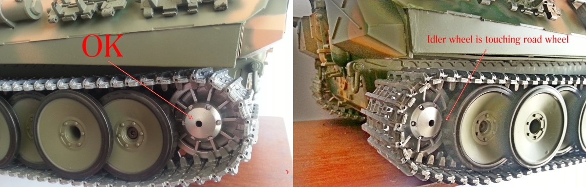

found the problem to the one track wanting to come off. they installed the Tiger 1 Idler wheel, i know its the Tiger 1 because i tried out my plastic one idler wheel on it,which i kept them from when i switched to metal tracks on my Tiger 1 so its a bigger size then what its supposed to be and it touches the road wheels..
