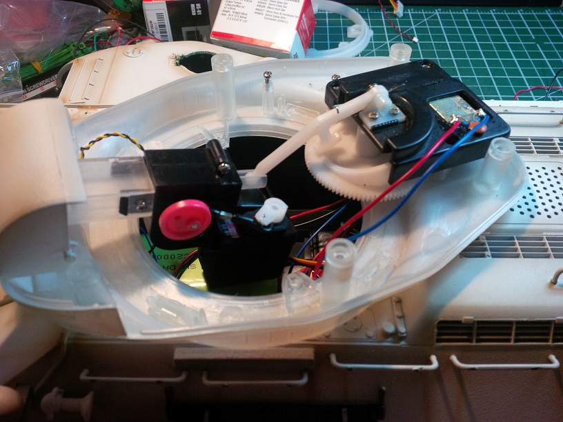

Thanks Ian, thats a great start, I had seen that on the clark site but what I was really looking for is any pics of how people have both recoil and elevation mounted, I'm really new to this rc malarky and I want a good idea what to do before I start hacking it apart

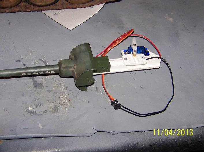

Here you go
What I did was get a Heng Long recoil unit, cut the bottom half off and binned the gears and motor etc. Then glued servo to the side. I found I had to reverse the servo setting on the clark to make it work correctly.

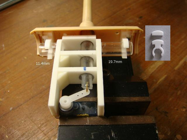

This is a picture from the clark website
And something completely different....... WSN
My not so good copy of it.

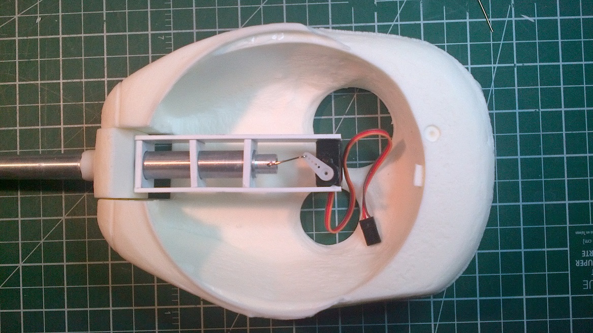

I am also finding that you get more recoil travel using the HL BB frame rather than the stock IR recoil frame. You can get 10mm-15mm travel from the HL Recoil frame but with the right servo I have managed to get 20 mm travel with the BB frame. Same idea as in Ian's picture, just gut the sucker and keep the "piston" to mount the barrel. I have also shorten the "piston" on both the IR recoil and the BB unit just to get more travel out of them.
Also, I was going to put in servo elevation on my last project but didn't end up doing it. With the Clark rewiring you have independent control of elevation already with the stock hardware so ripping all that stuff out for a servo elevation doing basically the same thing is not quite worth it IMHO.

Post by Dragon245 »
I went for this method on my T34/85
