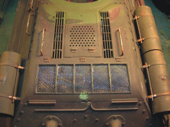

Not sure why I milled out the vents in the engine lid...I don't want to use household screen for it... and the photo etch isn't available separately...hopefully I can come up with something suitable :crazy:

Noy sure if you like mine or not but it is a splatter screen for covering a frying pan when you are cooking things like bacon. cost me a buck at the dollar store and I have got 3 T-34/85 screens out of it so far. I'm a cheap SOB when it comes to mods. :D

Yeah I did like those... I thought they were photo etch :O ...reason I thought someone sold them seperately :lolno:
Thanks dgsselkirk.. You know ... I had one... but threw it away awhile ago... never used it.. dang!!!! :-<
It's ok I'll find another :haha:

Sorry guys... didn't get much done today...went searching for a nice spatter screen... couldn't find one as nice as dgsselkirk's :'( ...So I went with what I used for my JAGDPANTHER...here's the result ...be kind :{
the spatter screens I found had a similar pattern... but seemed off scale..probably more suitable for 1/35th scale models.. This stuff is from a pen/pencil holder .. I changed the pattern by hammering a couple of them... and staggered them on the installation
I then went on to finish the engine compartment and securing the deck lid to the upper hull
after some research found the T34 had heat control louvers covering the fan/exhaust / air filters...so I recreated that...synchronized them by fabricating a linkage so both will operate at the same time....tried to link it to the opening and closing of the drivers hatch... but the mechanical linkage proved to be too long.. so there was too much flex in the opperation...so I will probably attach it to a mini servo...later ;)
That's it for now... sorry dgsselkirk.... my grates don't look as nice as yours... but at least I got them done :thumbup:
