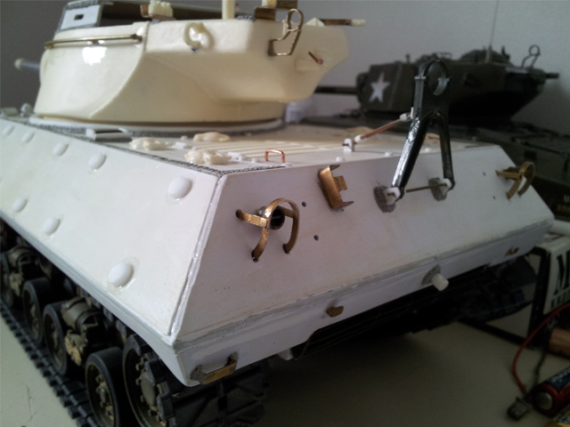

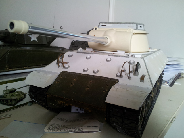

I'm building a M36 Jackson and I have a doubt about the correct Olive Drab. The Tamiya TS-5 indicated for the 105mm Tamiya Sherman seems very dark. Does anyone have any alternative spray paint? A lighter shade?

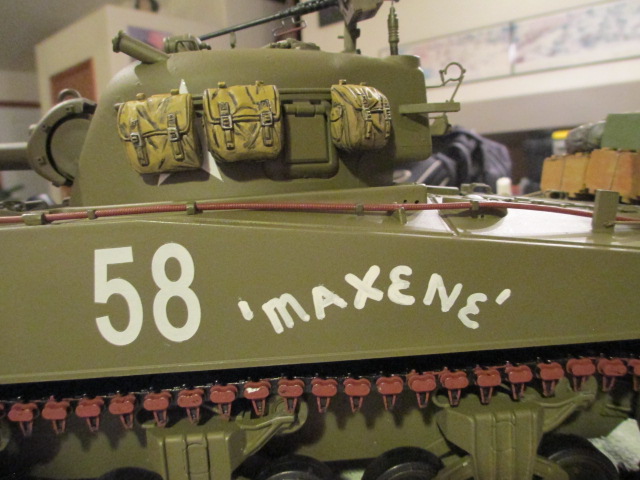

TK,
Let me toss my hat into the ring as well, Model Masters Olive Drab in the can # FS 34087. The paint in the touch up jars is labeled the same and dries exactly the same shade. I was amazed as such was not the case with paints back in the day. Example: 'Maxene', painted with the Model Masters. (Pre weathering)
