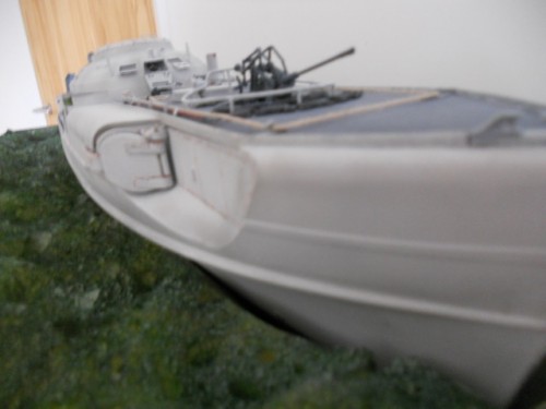

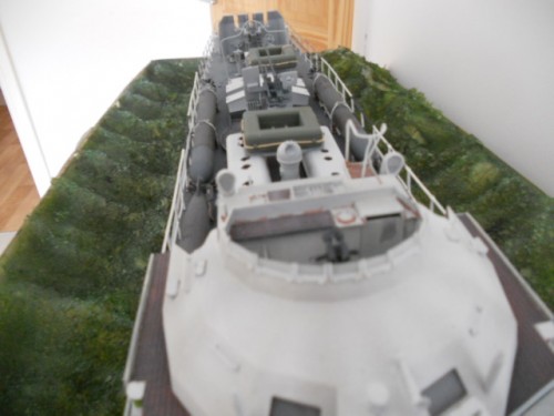

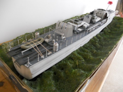

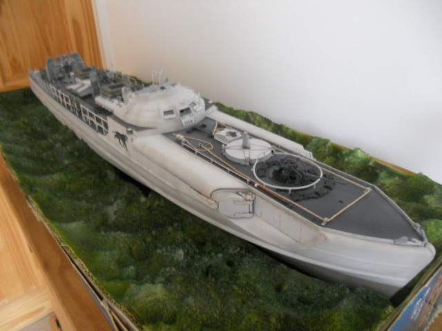

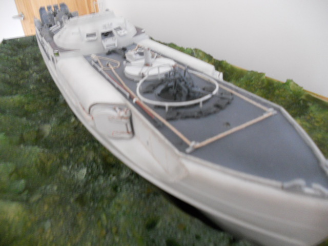

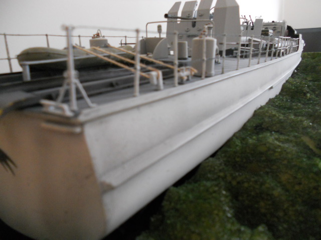

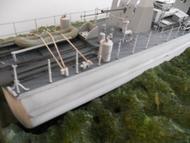

1/35 scale Italeri Schnellboot S-100. Fitted with 3 x Speed 400 motors and full channel mixing.
Took a few months to build as the kit has 600 parts, it's a static kit that has been converted to RC.

Excellent build there Wobbly, looks very sea worthy...

It's a very fragile model, the biggest 1/35 scale boat that was ever built and I think its out of production now. Some of the parts broke just getting them off the sprues no matter how careful I was, which meant I had to make replacements. I was pulling my hair out some of the time, but I got there in the end.
Once the school holidays are over I will take it to a local lake for sea trials, I would rather not have 50 children watching while it sinks to the bottom never to be seen again. Lol.

Very Nice, was the hull a one piece construction or 2? I built the E-10 in 1/72 with similar problems. The hull being 2 piece and a real problem to assemble straight and solid. adding internal bulkhead and a lower floor for strength.
The deck also was very thin requiring additional supporting. Yet I passed on the RC Conversion,would like a follow up report on the maiden voyage. Best of luck. fine work you have done.

There are two versions of the kit, the standard and the photo-etch version. This one is the PE one.
The hull is in two halves ....lengthways. lol.
To anyone even contemplating one of these, I suggest that you visit a psychiatrist before you do so, it was a real pain in the backside, and the PE is microscopic. An awful lot of people abandoned the builds, and fitting RC gear is a squeeze. This could well take you 6 months to a year to complete.
Additional resin parts on the boat are the rear gun armour and the dinghy mounted on the mine laying rails.
You can still buy the crew sets, and other bits that used to be made include mines, and depth charges.
I also have a 'corrected' resin armoured bridge with the 'correct' rivets (yes, you can count them), but didn't fit it as I didn't want it getting broken.
The model would be fine as a static, but I know that one false move sailing it and bits are going to break, they are 100% brittle. I had to make a couple of bits from brass and styrene.

As you have stated,very brittle kit. My S10 (Static) required a complete lower floor and bulkheads installed just to secure the two halves and ensure a proper main deck fitting.
Perhaps we could post a comparison set of pics to detail the evolution from the early designed boats to the later war,the advancements to the bow and wheel house were substantial yet the hull form and running gear remained basically unchanged.
These were the fastest Military ships of WWII ,sad that none have survived save one.Even our PT Fleet which numbered over 500 at one point now stands at 5. Well done Rob,if you agree to a few comparison photos let me know how to proceed,should not be difficult,maybe an over head and a side view to show the changes?
