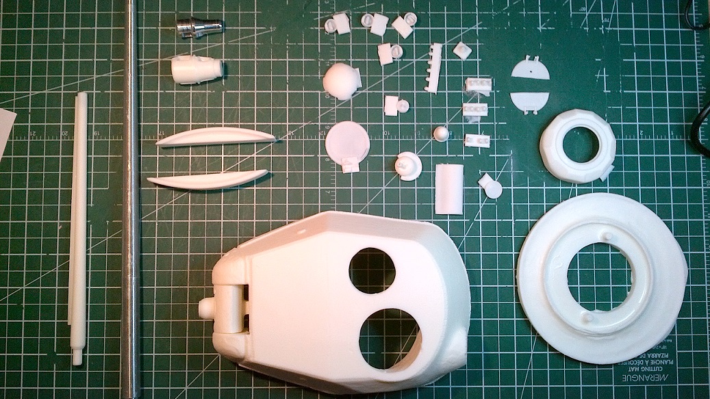

This is my second Juckenburg kit and I am considering a third one, but the challenge with both of them so far has been the barrel. The resin barrel is very fragile, and on my first kit (SU-152) it took me quite the effort to hollow out the 152mm barrel. The 85mm barrel that comes with the kit is not hollowed and I can't imagine the effort to hollow it out so you might need to consider sourcing a 85mm barrel from a WSN T34/85 or a metal version. I was also a little disappointed that the loader's hatch which is molded in one piece including the hinges. The SU-152 has fully operable hinges.

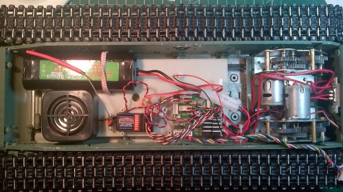

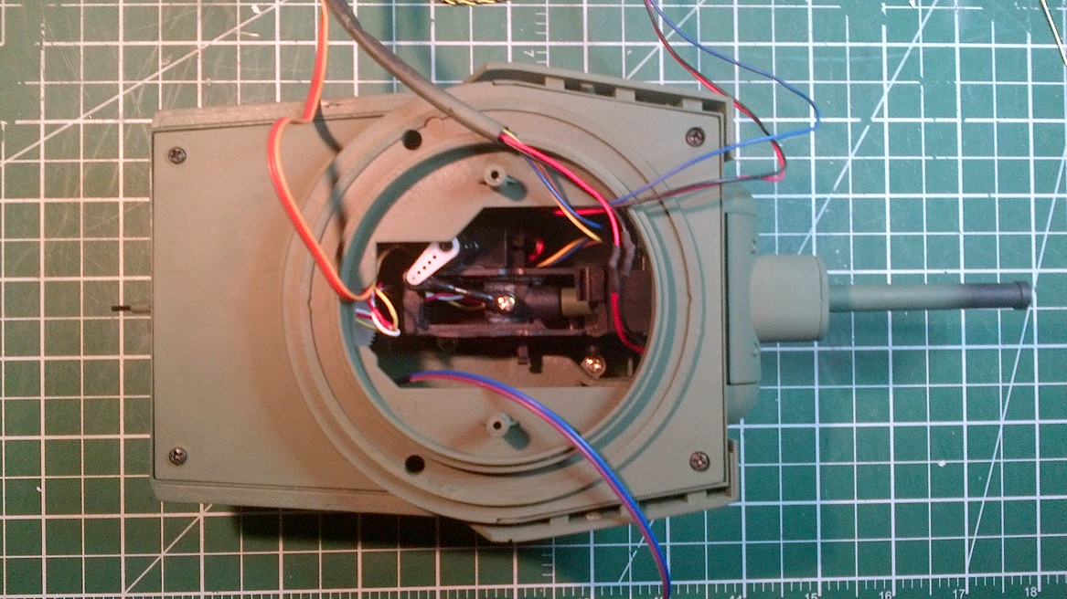

Started working on this a while ago and I am terrible at keeping track but here is a shot of the converted Clark TK-22 from stock Taigen. It is pretty well a straight swap of the MFU, the main difference being that if you are using stock flash unit you will need to get it hook up via an "extra" small plug onto the TK-22, as well as the IR emitter. This will bring you completely over to TK-22, but of course not taking advantage of the added features yet.
Next picture you will see one of the added feature of the TK-20 series is the fact that you now have directional control on the elevation, even if you are not converting to servo elevation. I have added the 4 pin plug directly onto the stock Taigen 8 pin hull plug to make things simplier and it is highly recommended. Two pins will be connected for the elevation motor and two pins for the stock recoil motor.

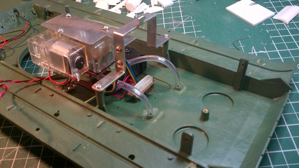

This pic also show the relocated smoker, which is now attached to the upper hull. Upon closer inspection I realized that replacing the rear deck on the KV will not actually affect the smoker location, and since Taigen does not use any of the old HL mount points (i.e. the tab mount on the rear side area) taking out the rear deck actually will not affect rigidity or create mounting issue. I might still come back to this at a later date.

Here you will see that I have mod the original HL recoil unit into a servo recoil, as well as updated the IR emitter with the extra small plug that Clark uses. I get my Clarks from Curtis at Immortal Hobby, and he always include two plugs (Flash and IR) with every board (Thanks Curtis !). Since I also use Hammerhead, I have also created some Hammerheads that has the extra small plug at the end for the IR.

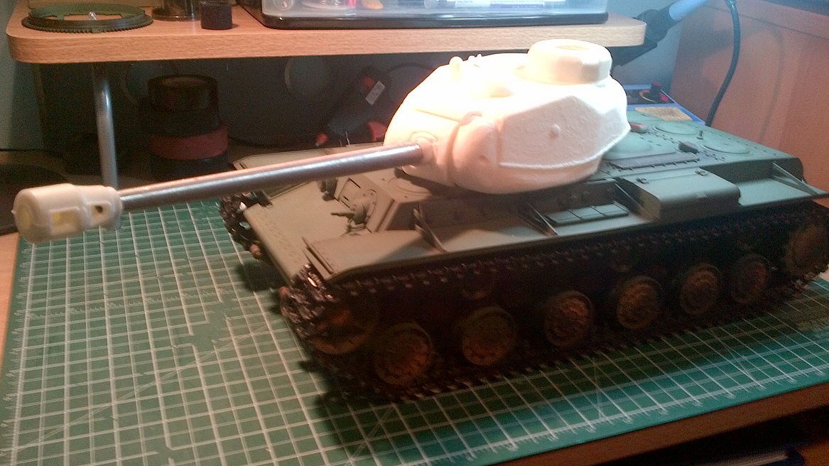

One of the other major goal in this build is to create a servo recoil for the 122mm. As mentioned before I have a spare Asiatam Elephant 88mm/L71 which has roughly the same shape as the D25 122mm at the back end. Couple of decisions. The German style muzzle brake that came with the 88 is a possible solution (Looking at the reference pics it is actually not very clear whether the muzzle brake is the German style one or the classic JS series muzzle brake). I have also seen pics of early JS1/2s that has the German style muzzle brake as well. However, the tapering of the 88 doesn't really work, and the muzzle brake that was shipped with the kit is HUGE when mounted on the end of the 88. So after some scaling down from 1/35 plans, I cut off basically the taper end of the 88 and fitted the Russian muzzle brake from the kit onto the 88:

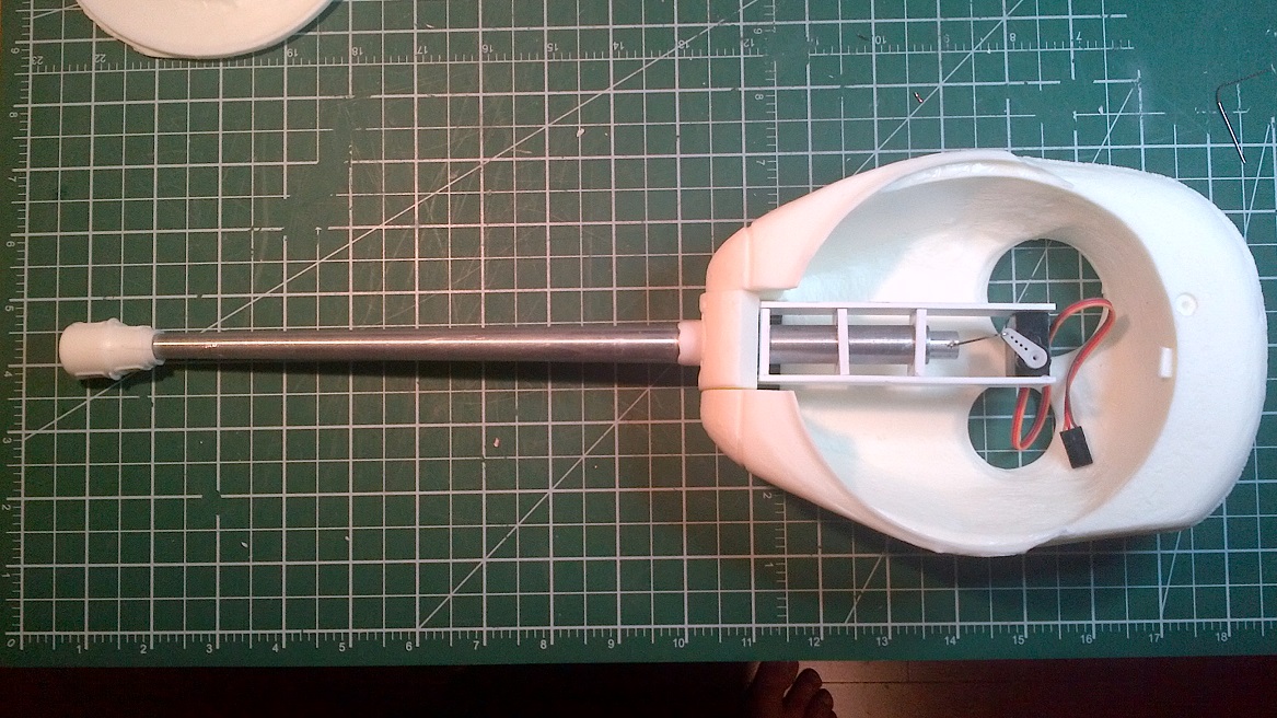

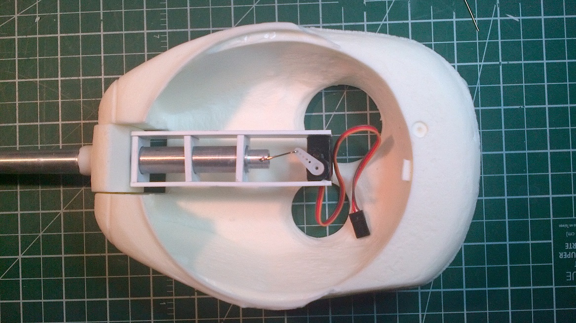

As you see in a later picture, it doesn't look to out of place, and I have a softspot for the JS style muzzle brakes so it will be so ! Being a resin kit, I have to basically build a recoil mount for the barrel, as well as some kind of elevation mount which I haven't decided on yet. Here is a larger picture of the recoil mount:
It is basically a direct copy (crappy one at that) of the mount as illustrated on the Clark website. The turret is very cramp and I have to use a mini servo and be very aware of the spacing to make it work. One of the reason I have not decided on elevation options yet is that there might not be room at all and even if I do managed the range of elevation might be so small that it is not worth the effort. TBD.

Nothing glue in yet but here is the mock-up so far, just to get a sense of the scaling of the muzzle brake, the length of barrel (Using the Bradford AFV Plans) and the overall look of the final tank.
The muzzle brake in real life doesn't look as imposing as in the pic, but I might still need to do something to make it appear smaller. Next week's to do list would be:
